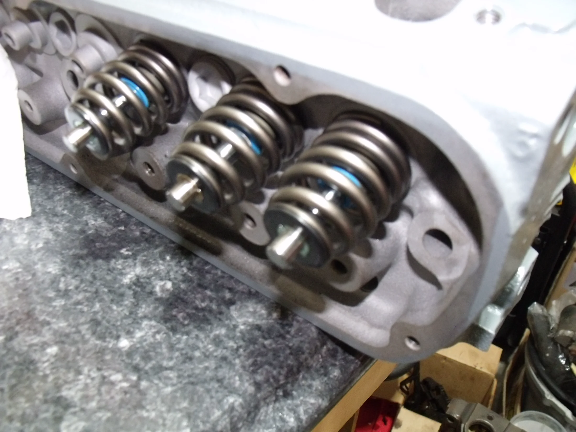

I used these Beehives from Alex's parts on my P heads...
I am assuming your 91 is a 5.0 - you didn't say specifically.
The 19 lbs injectors will work fine (use the Mountaineer ones) unless you plan on running at 5000+ rpm for extended periods - you will max them out at higher rpms. If you plan to cruise around, maybe low 4000 rpm runs, the 19s will be best as your computer already wants to run them, no tune or calibrated MAF will be needed - and you already have them.
The Mountaineer TB will be plenty and will work great. You will need to swap the throttle cable mount as described in the post above. The TPS is a different plug and the fox one may need a slight trimming to fit if I recall.
Valve springs - I agree with limp and would do the same - go to Alex's Parts and get a set of their GT40P specific spring sets.

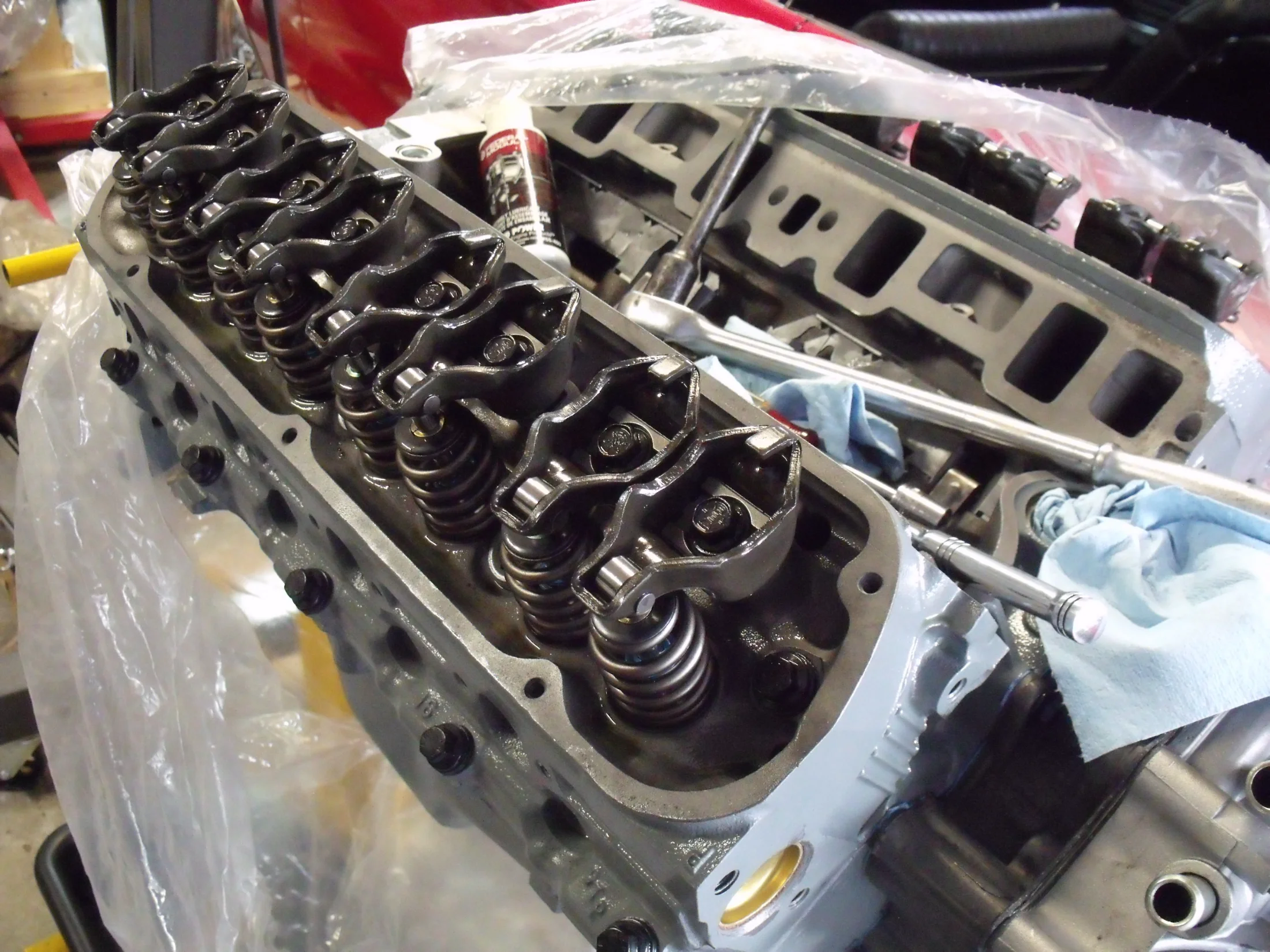

My set up is GT40 3-bar Explorer heads (smooth finish, mild ported), Crower cam (.527/.544 lift with 1.7rr), untouched Explorer EGR intakes, C&L 76mm MAF, 1.7rr. I started running this combo with Explorer 19s and as 86HO5.0 says, at high rpms (5500+) the duty cycle on the injectors would blip/hit 95+% briefly so I switched to 24s (pulled from a late 90's Navigator). I then math'd my own sizing for a flow tube for the 24s (actually did the 19s first with great results). I will be using the 73mm C&L and Explorer 19s on my son's 89 GT we are building - Explorer EGR intakes, 65mm TB and GT40Ps as well with the stock cam and rockers.
