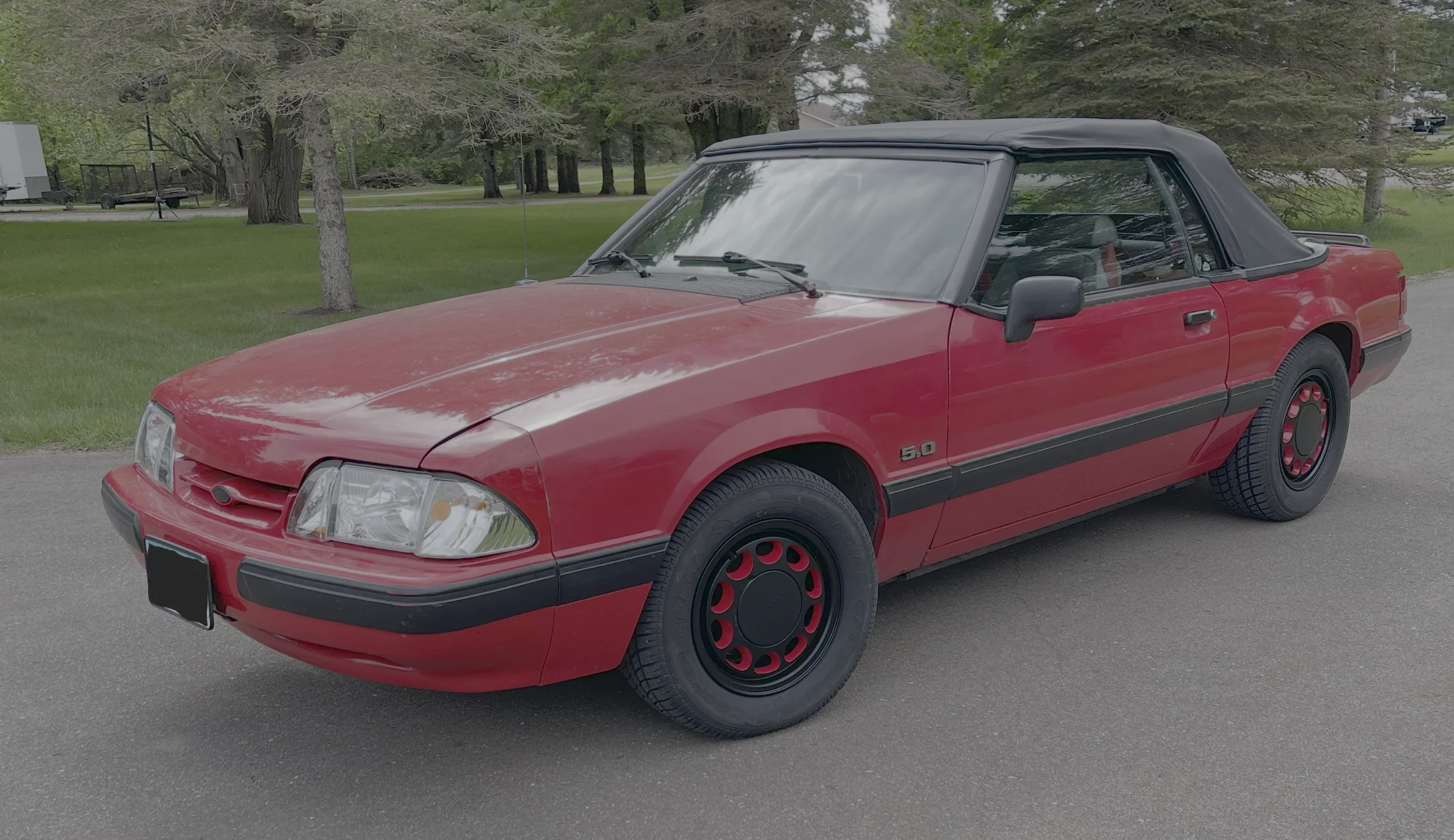

Oh I finally got my top install all done finally and my redone wheels installed over the weekend.
