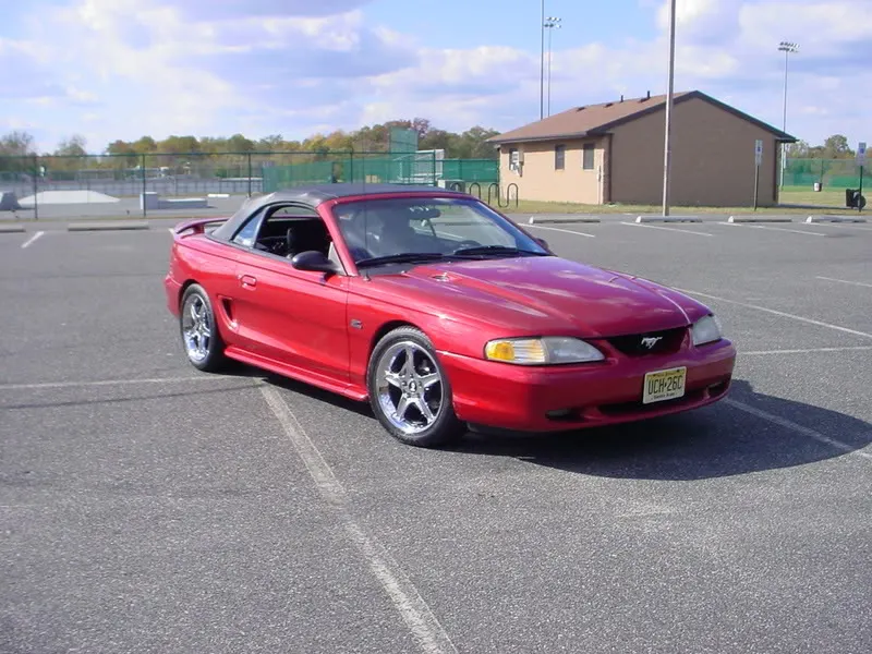

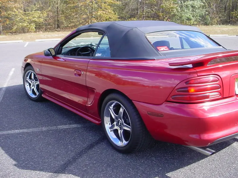

I'd be hesitant to do the Sportlines. Sig pic below was an off-brand, but lowered about the same as the sportlines do. I had to replace them because I was dragging getting out of my driveway. I'm running Pro-kits now, and like them, although I still have to be careful going over speed bumps, etc. I can't imagine running anything lower.
Oh, yeah--I did the MM c/c kit, and wouldn't do any drop at all without adding a c/c kit. FWIW, I don't have a bumpsteer kit, and haven't felt like I need one.
