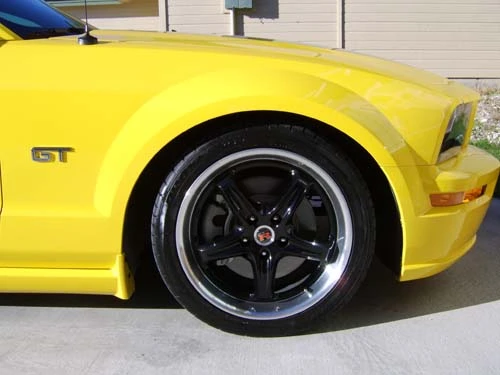

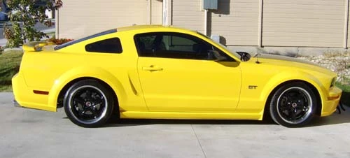

Here's a couple pics with the Sportline kit installed (compliments of drafthorsepower from 2005stang.com).

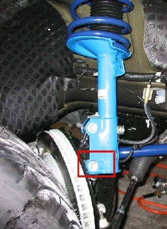

The guy isn't yanking your chain. Attached is a picture showing the problem. There is a camber bolt that goes in the bottom hole. The bottom hole will need to be opened up toward the strut, or if you are looking at the picture, to the right, if you were staring directly at the bottom bolt (bottom bolt = one closest to the ground). They just need to open up the hole so the hub can move back some. Unfortunately I don't have a picture of the bolt but it looks like a bolt with a washer mounted off center. I had to do this with the FRPP kit which comes with the bolt but absolutley no instructions on how to use it.

I would purchase the "camber adjusters" regaurdless which springs you have.
The springs are what they are, I dont think your going to change them now.Take the car to a good alignment shop and have it aligned...
Steeda also makes a camber kit.
You may also find that the rear end and pinion angle is out of square due to the lowering. you can fix that with a adjustable panhard and third link.

Here is the update. The springs are black and I checked the numbers on the actual springs and they check out. I called EIbach and they said they sold a kit that would fix the angle for the alignment. lbc50 pretty muched stated it as there is a bolt that needs to be installed to make it work. Still strange though as Eibach said they hadn't had any problems with any 06's yet. I guess I should feel special. Thanks for all the input and I will give you an update once the alignment is done.
My ProKit was scheduled to be installed in my '06 this weekend... Then vendor contacted Eibach and the also recommended a 'kit' that would be needed $15.00. Kit and Pro Setup will be in and installed next weekend. So, Yes, it does sound like there is an additional component needed for the '06's.:nice:
I have presonally taken my car apart twice now. The thing I was wondering, is why don't they elongate the hole from the factory & why don't the aftermarket struts come with an elongated hole??? Well someone, very knowledgable told me that VW has the patent on that process and therfore they leave it up to the individual to do it. Don't know if it is true or not but seems reasonable.
Whatever shop does the work will need to modify your strut slightly to work with the bolt. It should easy work with a die grinder.
