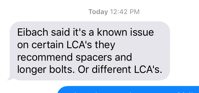

That’s what I was thinking to, I asked him to snap some pics so I could see where the spring perches were as maybe they are reversed, but from what I saw in the vid I couldn’t tell. Then I thought wouldn’t flipping them move the perches to far from normal? He called eibach and this was their response.
I have the Eibach sway bar on my car and it fits fine. I have MM adjustable lower control arms and the tab is in the middle.
I suspect it is a problem with the lower control arm design and that's why it didn't have a sway bar on it when he got it.
His best bet would be to pick up a new set of lower control arms.

So he put 1in spacers on each bolt and it mocked up. Idk how great that is but it looks like it works.
