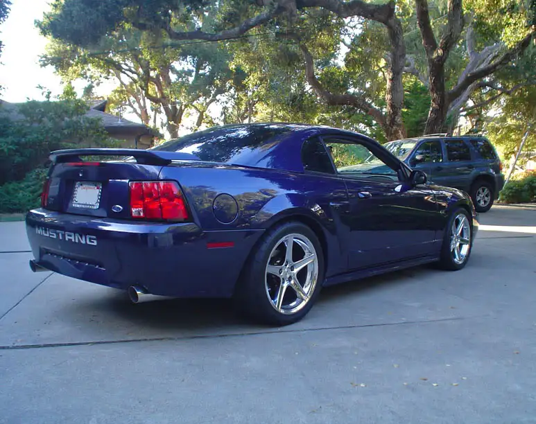

roush springs lowered the rear about 1.6 - 1.8" i'd say. (i do have a heavy sub and box in the back tho) Almost as low as the sportlines SHOULD sit. they worked well, but they dont seem as stiff as sportlines. and they are still pretty low... if i could do it again, i'd get steeda sports in back to not lower it as much.
Here is a pic with the roush springs in.
Damn thats a nice gt! What size tires do you have in the rear? any rubbing issues?
""Yup, had 2 girls sit in my backseat yesterday and went over a bump or two and now i have some tire shredding in the back. Nothing thats major or dangerous, but definitely noticeable. This is crap, lets do somethin about it''
295/35/18 BFG KD's in the rear :D
Yea i had huge rubbing issues with the fenders when i had the sportlines in. And the saleen replicas sit out really far in back due to their offset. I ended up losing one of my rear tires due to rubbing and shredding.
Currently, I do not have any rubbing issues at all because i put the roush springs in the rear and rolled the fenders....i think rolling the fenders is the only thing keeping them from still rubbing.
