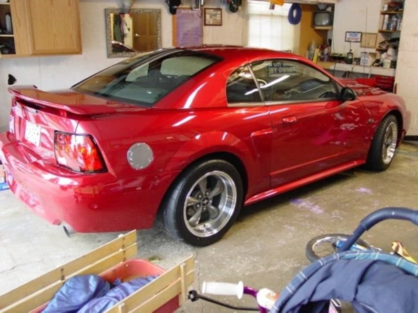

Here is a pic of mine with sportlines, but I left all spring isolators in.

very clean drop Xstanger. Looks very nice, how's the ride?

Ride is fine. Not to stiff, not bouncy and just about perfect in my opinion.
