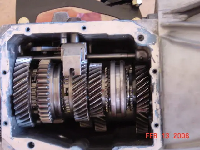

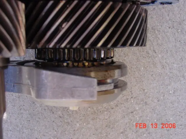

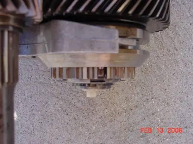

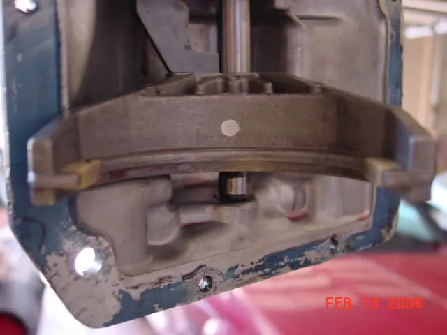

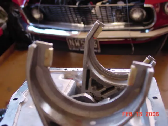

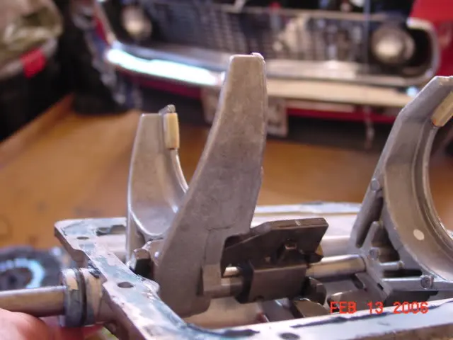

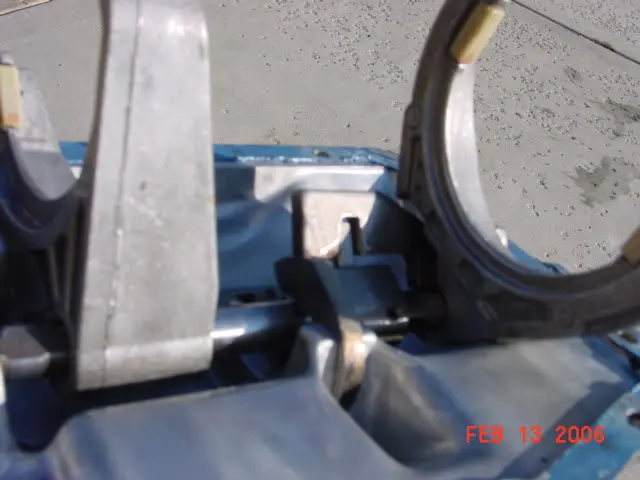

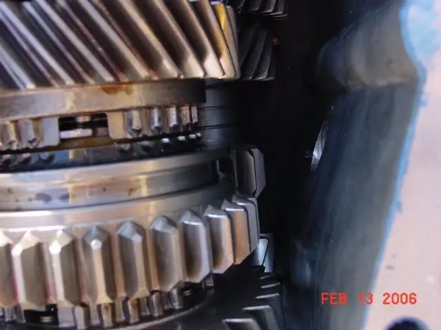

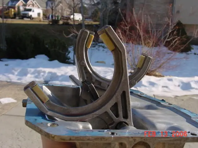

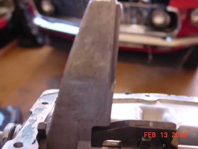

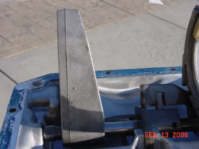

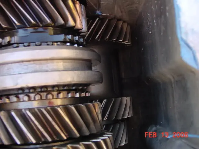

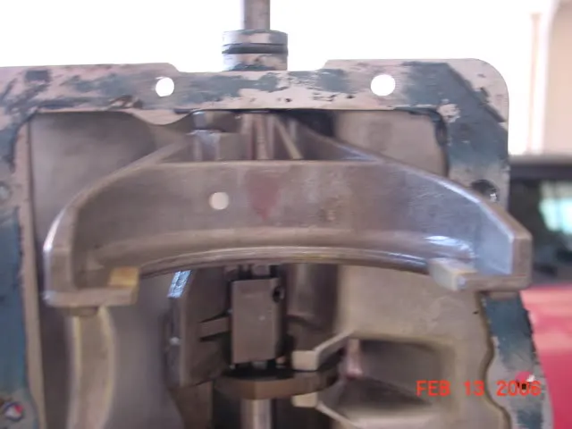

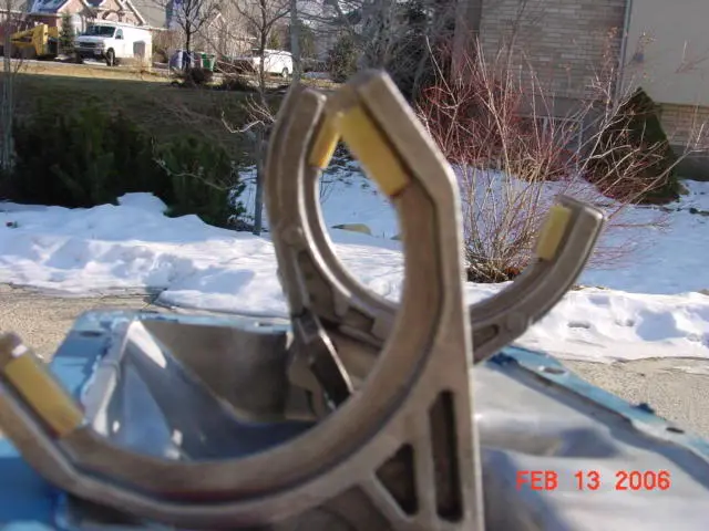

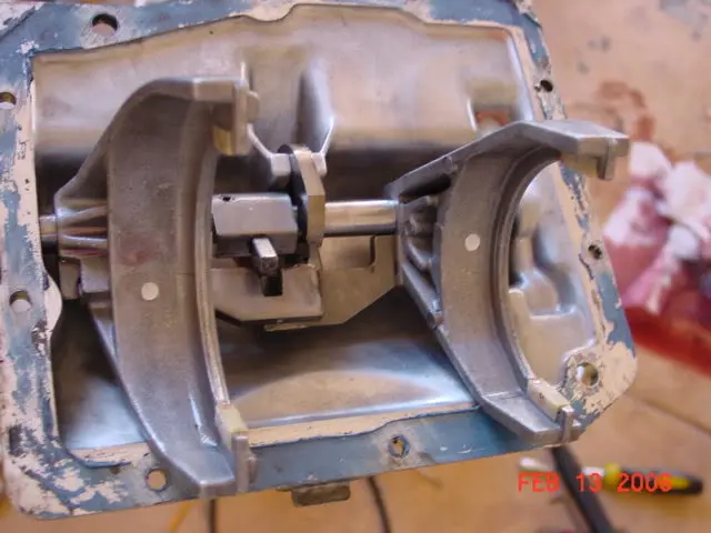

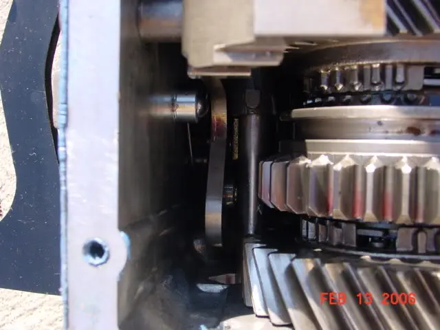

I finally took the tranny apart. I bought it rebuilt off of corral. I verified that it is a T-5Z by counting the number of revolutions of the input shaft and the 1st gear. It was 3 turns exactly. So it must be the 2.95 which is the Z-spec. Anyway the thing was having problems going into gear, sometimes it went right in and sometimes it was like hitting a brick wall and would not go in. I called D&D they said it was a clutch issue, which means my stupid hydraulic clutch wasn't disengaging, but it could be synchros, or bent shift forks which is unlikely. But while it is out I would like to have the peace of mind to make sure it is built right. Anyway I want to check out the synchros and shift forks to make sure that the internals are okay. Here are some pics for you guys. I have some vids but don't know how to put them up. I am searching to find them. Here are the pics.

I don't plan on having this tranny last much longer than a year or two at the most before my engine grenades it. Then I am upgrading it with a G-force. This is just temporary but it has to work. Hope these vids help. I want you guys to help me spot anything out of the ordinary. I am hoping it was just the clutch not disengaging properly.
The trans looks ok. If the shift forks were bent it would be somewhat obvious. Check how easy it is to slide the hubs into gear. Try turning the input shaft and see if any gears stick when trying to engage. That will tell you if there are any serious problems. To be quite honest, a visual inspection of the parts can only tell you something when the internals are seriously worn.
Good things to check..... when you drained the fluid was there metal flakes in it ? Look at the magnet and see if its covered with metal particles.

Pressure plate, clutch, flywheel, pilot bearing, fork, and everything are all new and have been examined those are okay. The problem is either it was not disengaging properly which I blame entirely upon the ridiculous hydraulic clutch and my inability to bleed it another 1000 times. Or something internal like the synchros, or shift forks. Shift forks are straight with no problems. But listen to the video when I put it in 4th gear and start turning it, notice there is some more noise than before like something is barely touching. When I push on the input shaft like the pilot bearing would it goes away and sounds like the other gears, check it out and tell me what you think. 4th gear is the very top gear closest to the input shaft.

I tried watching the videos but they were too chopy even on my 3mbit cable so I can't tell you from watching them. If the input shaft is loose then most likely thing I can think of while I'm siting in my chair is that the preload on the bearing is not set properly. From what I understand, the later modle T5's and provably a T5z use a tapered roller bearing which require a proper preload to function correctly. I would take it to a shop and have them double check the preload on it since you already have the sucker out and open.

Well I was going to meet my first ever time frame set. 2 weeks engine out disassembled cam swapped, whole thing redone with new gaskets and bearings, the oil pressure issue was resolved, I hate plastigage, the bearings were the wrong size when the plastigage said they were fine. Alas though another issue pops up, the tranny I bought 11 months ago, I took it to a tranny expert here. Well the thing is fried, all synchros and bearings are in need of replacement, the gearsets have 2 gears that are gone, Input shaft is gone and has play, 4th gear only had one good tooth on it, basically this thing has been beat up, and powershifted to death according to my tranny guy. So basically the "brand new rebuilt T-5z" I bought for $750 is scrap metal, I don't know why I bump into all the a55holes on corral. I get to delay getting the car done for another month, and need to figure out a way to try to get my money back from this guy if he won't let me send it back. I will even pay out of my pocket to ship it back. I am going with a G-force kit now that is why it would take another month. I can't bring myself to have invested over $1000 in this T5, I gotta go G-force. The question now is to go with dog ring or synchro assembly. Now excuse me while I vent.
