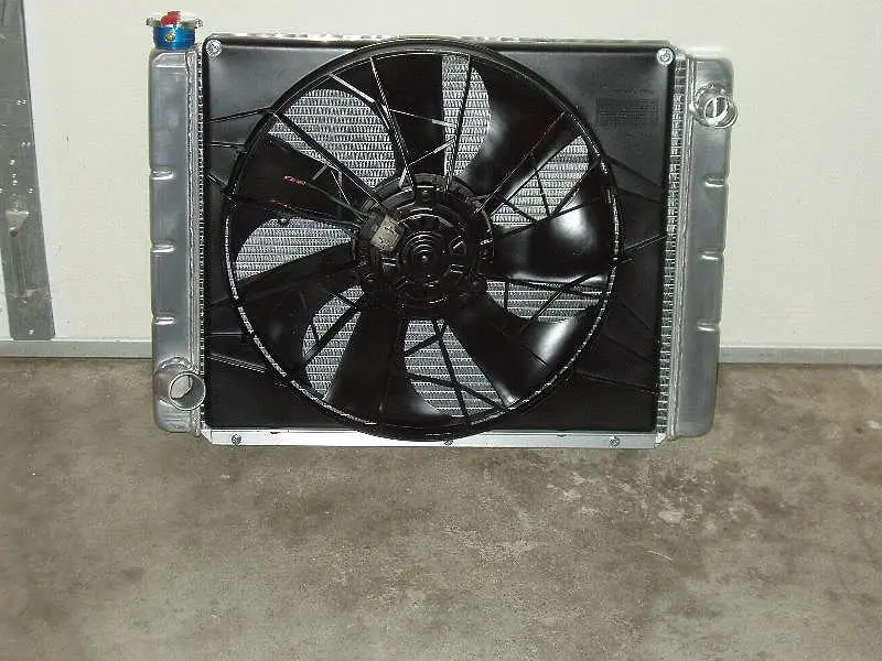

Here is the Mark VIII fan I mounted to a Summit radiator.
Here is my Mark VIII install information.
http://members.tccoa.com/392bird/markviii.htm
