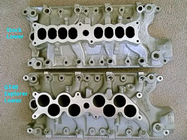

I never checked this. Good point. It’s a motor that I received already put together and just changed the cam. But I always assumed explore upper and lower. Assuming that they match. Have you ever seen anything like this or a list of things that could cause this?
I only asked as its not likely that the stock lower is on the car with an Explorer upper. You can see here the difference which makes is physically impossible. Top is a stock 1987-1993 Mustang 5.0 lower and the bottom is a GT40, Cobra, Explorer 5.0 lower.
