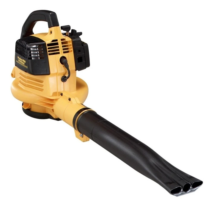

Electric blowers are awesome! I swapped out my Heaton M112 for this mad tyte beast:
How the hell did you get the triple blow out tip!?!? I've been on the waiting list for months!!:D
