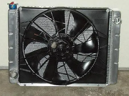

I used a piece of 1 inch aluminum L at the bottom, and small bolts at the top.
Thats a MarkVIII fan
Full install info:
http://www.qsl.net/wd4ngb/markviii.htm
Thats how I did it, and I shoved t atab on tha shroud between the endtank and the core, then got a piece of metal fo the other side, screwed it to the frame rail, and it's holding down that side of than fan.
Once it starts warming up around here I will be putting in my Mark VII fan.....I found it in a junkyard, and had to get it :D
A trip to Home Depot for some aluminum angle will get you the raw material you need. A hacksaw or electric sabre saw will cut it to whatever size you need to succeed.
