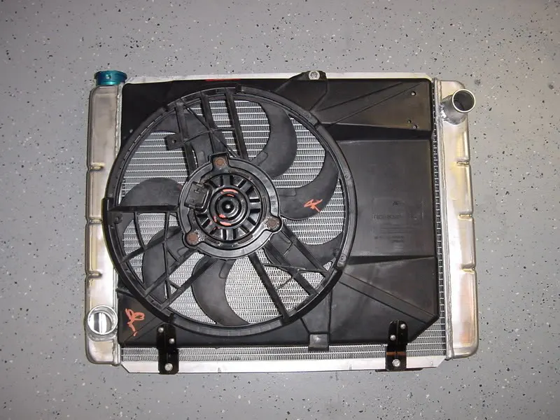

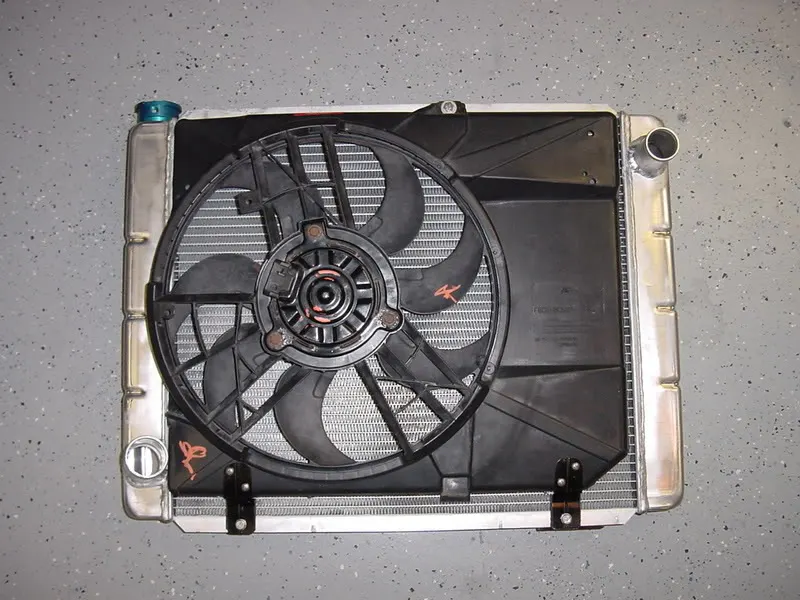

My Setup:
Taurus fan on Aluminum radiator:
Adjustable fan control:
It only has a 16Amp capacity, so it requires a HD relay.
3G Alternator

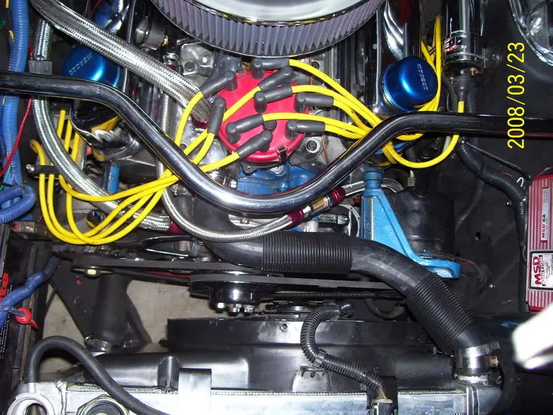

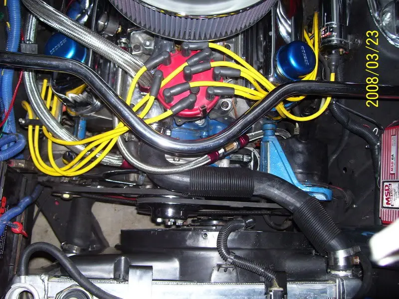

go with the ford taurs fan... i got one out of the junk yard for 35 bucks...best money i have ever spent. i have bought a couple different types of aftermarket fans and they havent even came close to the tarus fan. my car now runs a the temp i want from 140-210. just to mess around with it i turned the adjustable thermo all the way down on a 105 degree day and my car wouldnt get over 150 at stop lights. it was a tight fit, but i also bought a huge aftermarket radiator.
