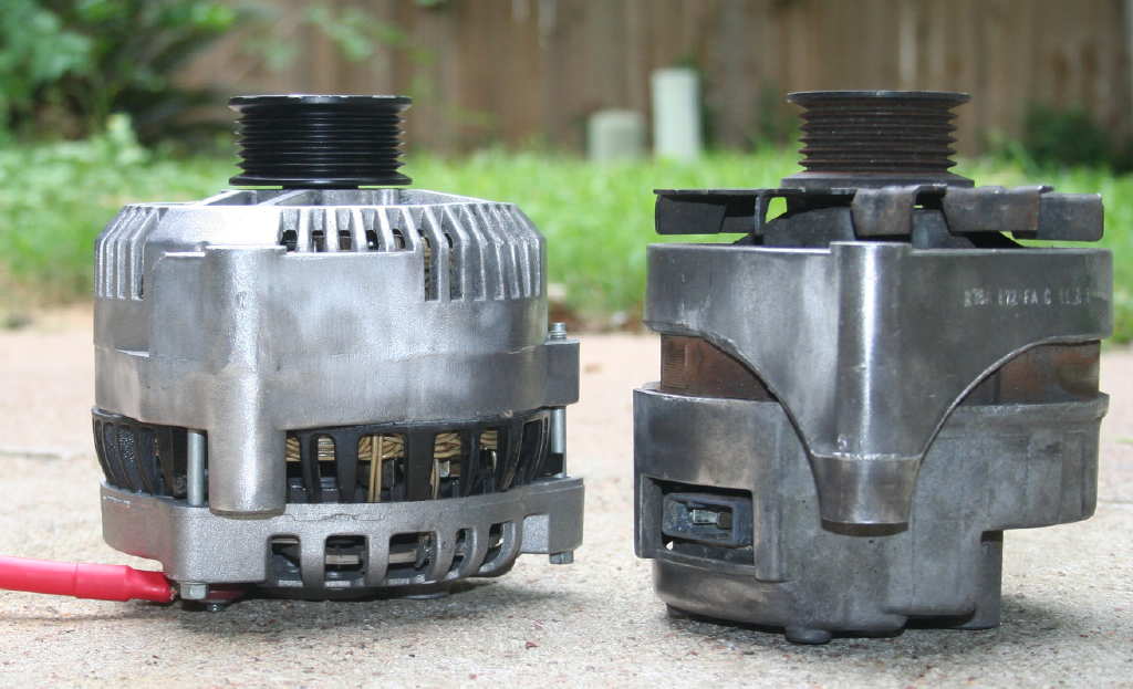

A related question. Do you have a 130 amp 3G alternator? That is a must with an E fan.

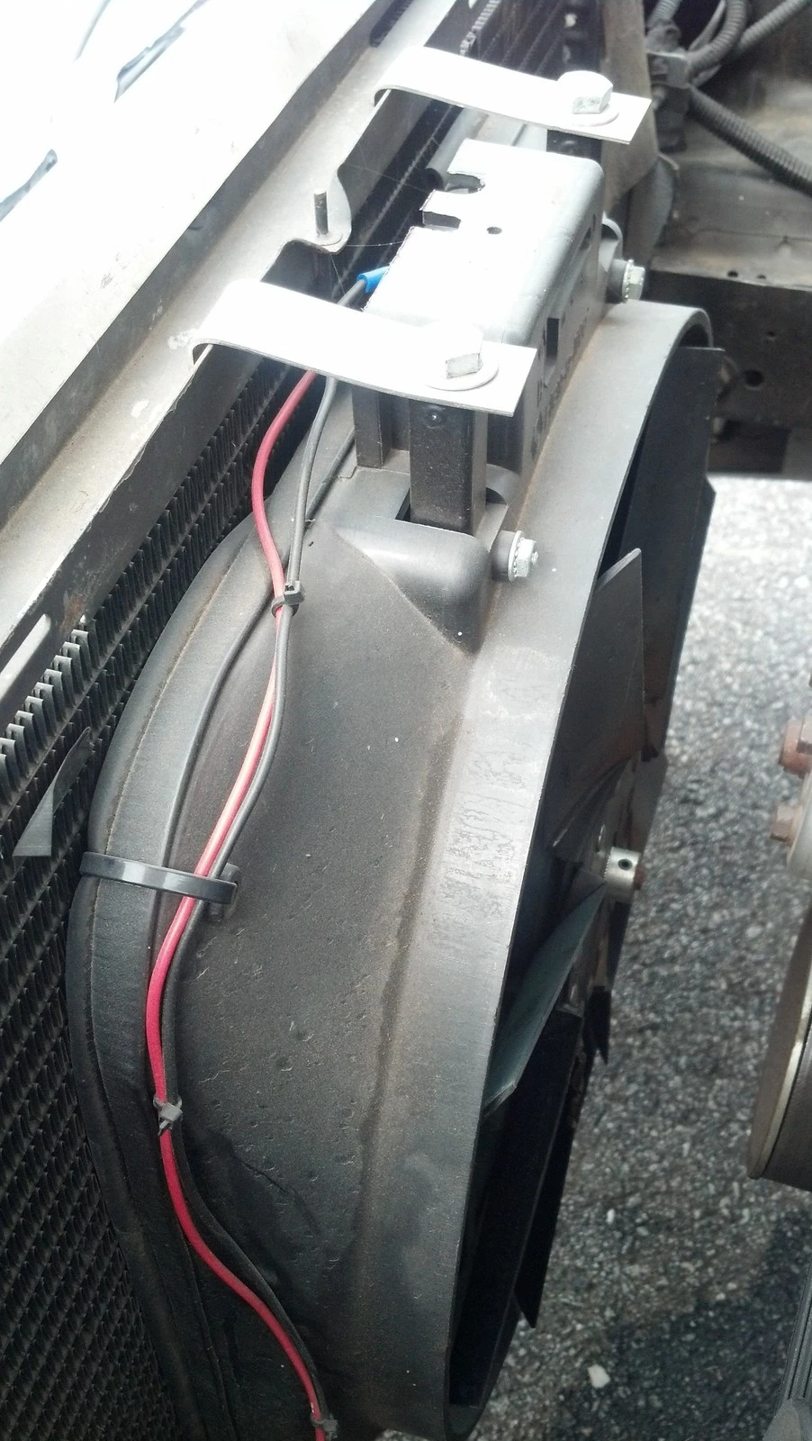

mikestang63 said:
Definitely a 3G. The fan is a Flex-a-lite. Look like this
http://www.summitracing.com/parts/flx-175/overview/make/ford
ok... that fan has an controller on the top of it that adjusts with the turn of the knob. That is the good news. The bad news is those fans are terrible and are notorious for the controller breaking, and the fan itself is not very good. Go to the FAL website or google and you will find the install instructions which will show you the proper wiring, What you need to do is install a a good fuse holder( large blade type 10g wire not the cheap little blade fuse with 14g wire) with at least a 30 amp fuse for the power wire to the battery side of the solenoid.
Make sure the ground is also attached to a solid ground point. Also, there should be a triangle shaped connector on the A/C power wire that feeds the controller. It turns on the fan whenever the A/C is on. You want to adjust the fan so it comes on about 5-10 degrees warmer than your stat.
Mine doesn't have an adjustment knob. I see the only i linked does, mine does not I'm assuming that changes things?

If you don't have a high current alternator, you can forget about using an electric fan. The stock 65 amp alternator on 86-93 Mustangs isn't big enough to run the fan and the rest of the car. If you have a 94 or later Mustang, the stock 3g alternator should be fine if it is working correctly.

jrichker, the OP said he has a 3g alt so he should be good there. To the OP, sounds like the controller for the fan crapped out like I said they are prone to, and the prior owner just hard wired it into the fusebox? Can you post a picture of the fan and the wiring coming off it.

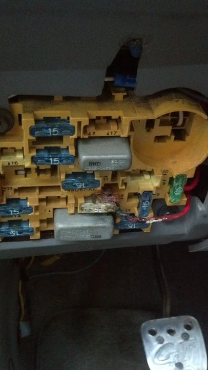

Their is one black and one red wire. The red wire goes across the bay into a little whole that goes into the drivers compartment and is wired in behind a 25amp fuse in the AC slot. Black goes to somewhere on the frame. When the fan stopped i just jiggled it iin the fusebox and it kicked on and got the temps down.

That attempt to tap the fuse is nasty looking. I wouldn't do that unless I wanted to burn someone's car up.
As mentioned, that wiring is a fire waiting to happen. Like I thought, the controller on that fan is broken and the prior owner just hard wired the fan to the fuse box . You now have a few options
1. leave it as is and hope your car doesn't overheat from the fan failing or worse burn up the wiring and car
2. correct the wiring and install a controller and keep the BM fan
3. correct the wiring, install a controller, and replace the fan with a better e fan
IMO you should at least do option 2 which has been detailed earlier in this post. You can do option 3 with a jy Taurus fan and a new controller for under $200.
