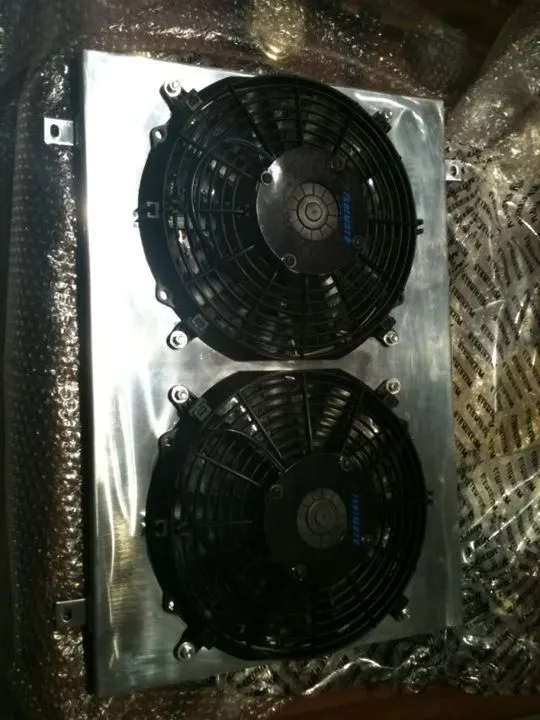

I hate the way my 92GT sounds with the stock fan / clutch system. With the electric fan on my 94 I could hear it come on and turn off. I really like the sound and look. Can't wait to get the stock crap off and install our new double fan system. Will be using the DSS controller set up.
