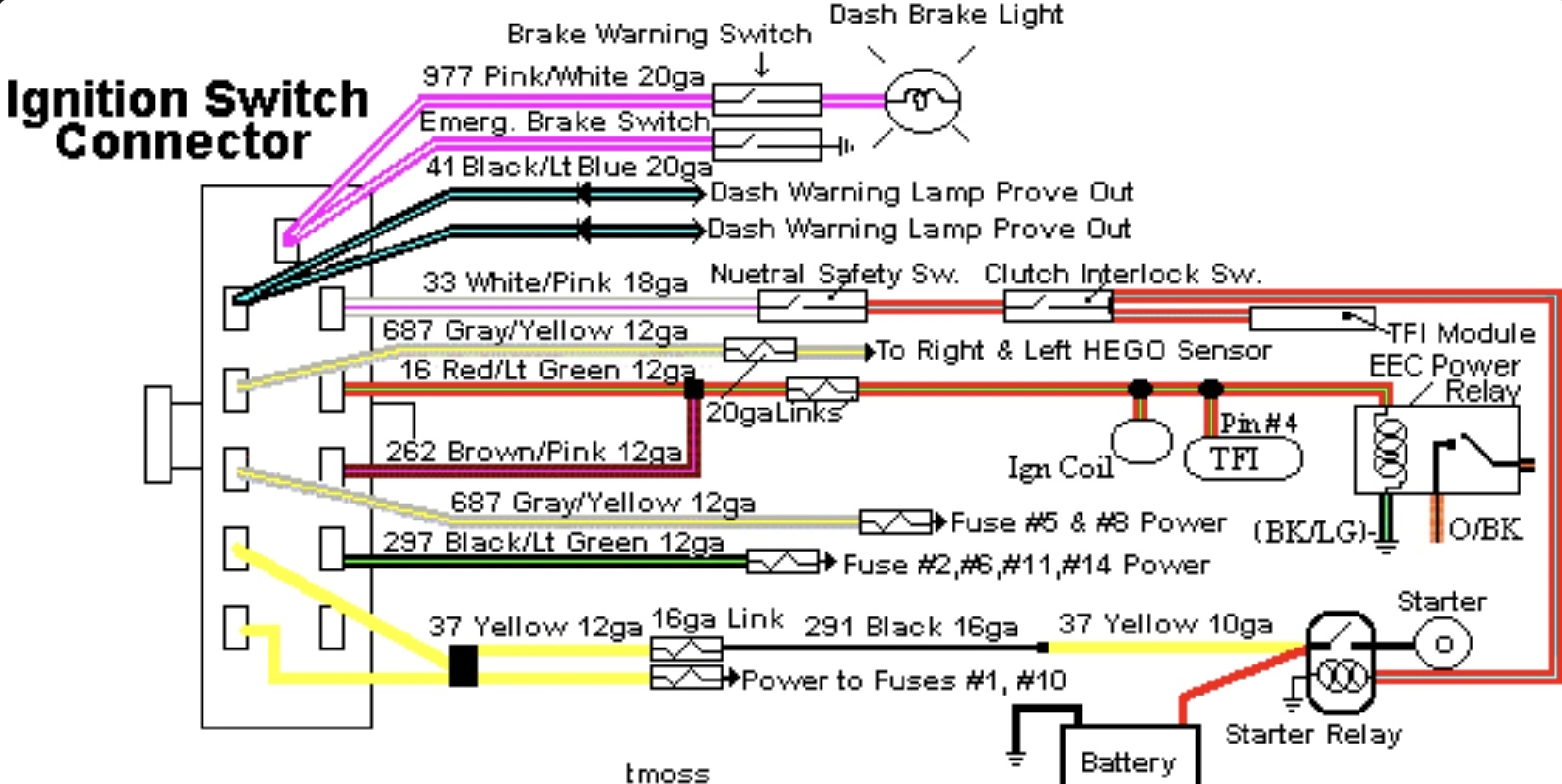

Have you seen this diagram?

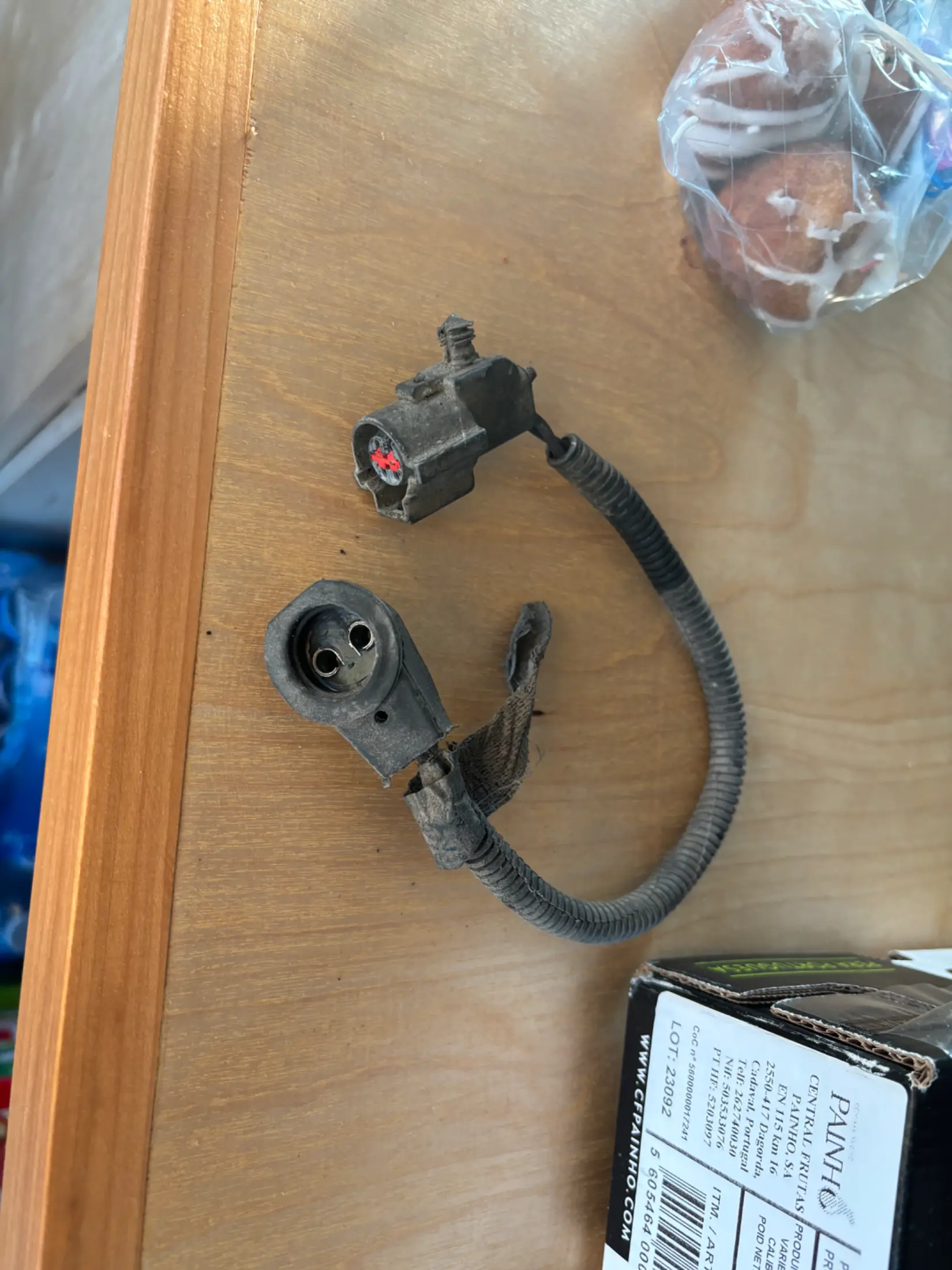

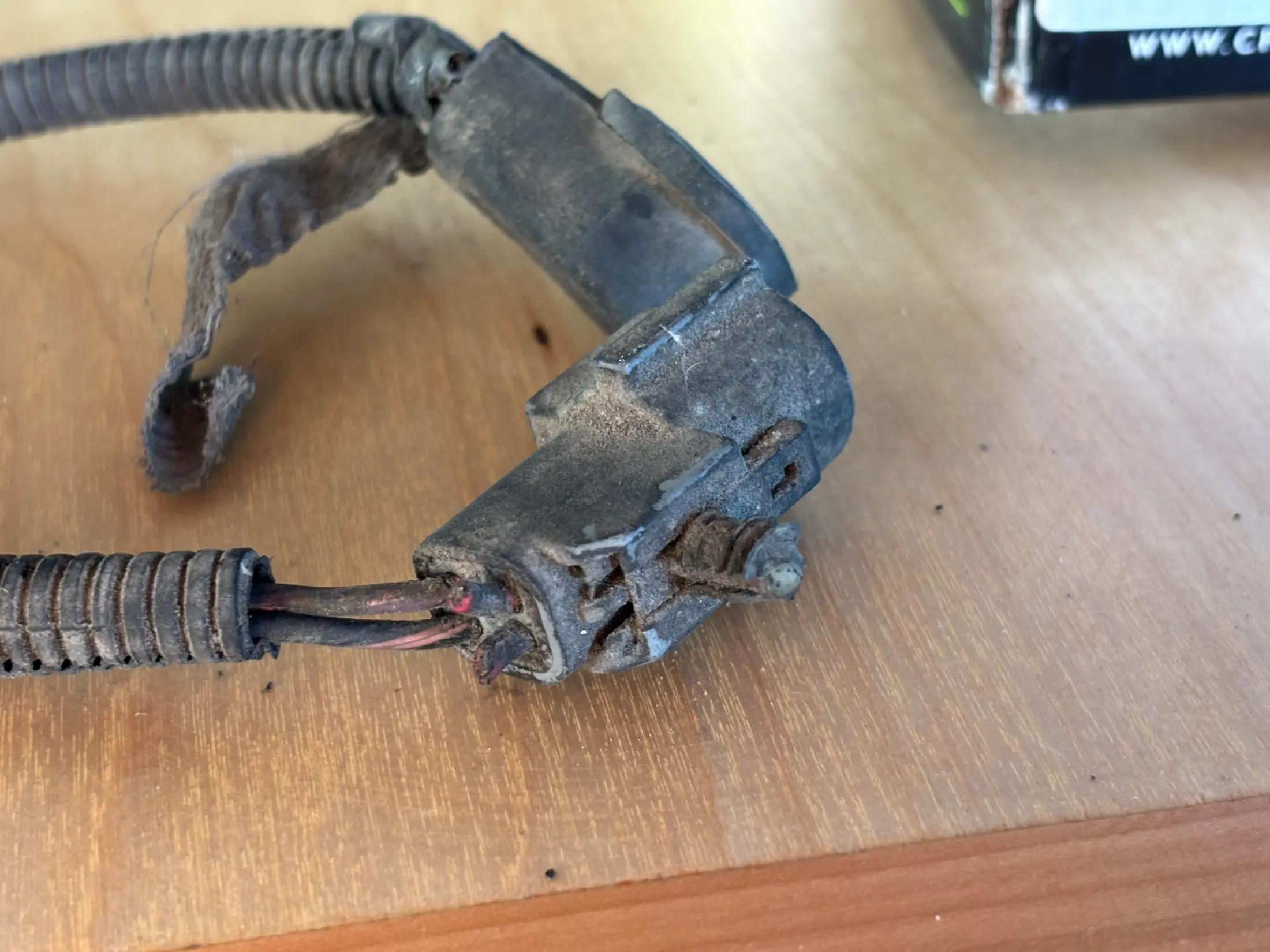

Omg…… I figured it out and incase anyone is having the same crazy issue I was having, it was the backup light harness under the car that plugs into the side of the transmission had somehow got the red jumper wire cut right off. That harness apparently prevents you from starting the car using the keys. Crazy crazy time finding that out so I hope my pain helps someone find this quick! Thanks for all the replies trying to help.
