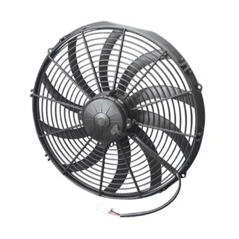

I bought a spal and finally connected it right, i am really pleased with it thanks guys. A little loud but so what, just turn up the radio.
