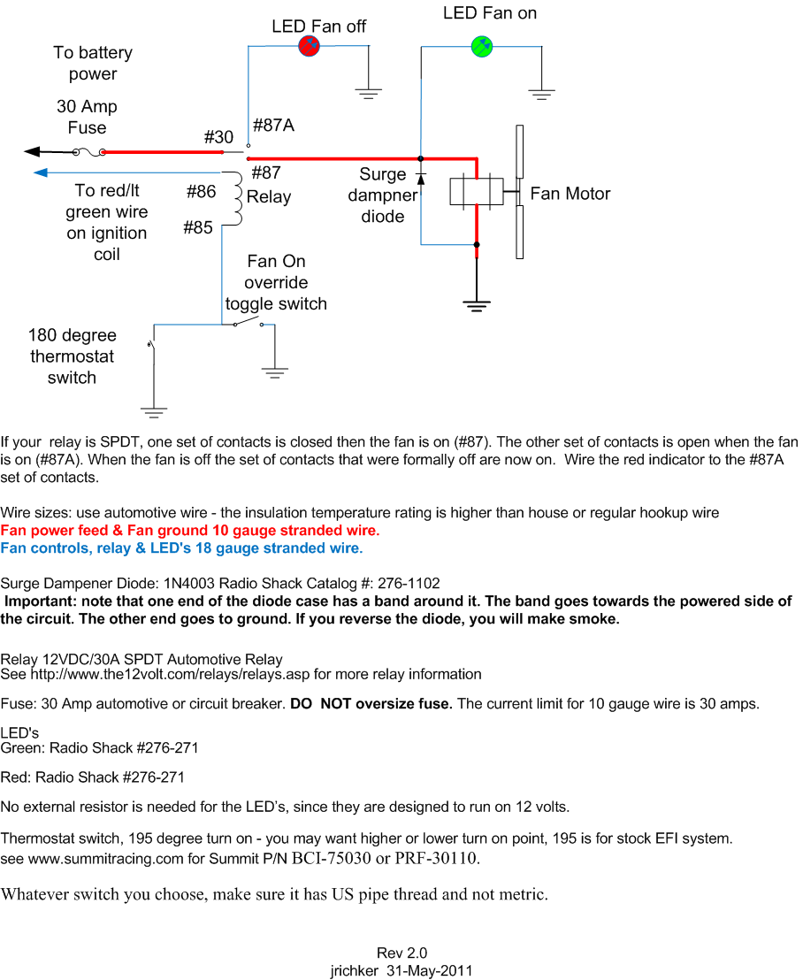

If you are good with electrical stuff (90% of the people here aren't), build your own controller. The numbers on the diagram (#86, #87, etc) refer to the numbers on the bottom of a typical automotive relay.
attachments\66614
Note that the temp sensor in the diagram needs to match the thermostat in your engine. The preferred arrangement is to have it open about 5 degrees above the thermostat.

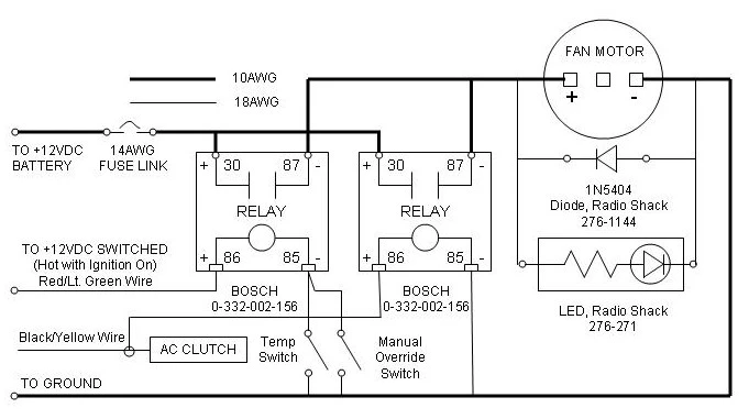

Diode for the relay or diode for the fan?
The diode goes across the relay coil or fan motor (both are inductors).
Diode cathode goes to positive, anode goes to negative, i.e. reversed biased.

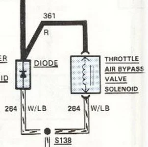

Same as the IAC (IAB).
631452
The Bosch relay has an internal diode.
631453
Blown88GT Thanks for responding and take the time to do so.
I understand the diagram and the use of a diode. What I want to know is how I should physically wire it. A diode is this little thin metal wire with something that looks like a capacitor or something in the middle. Do I literally put one end of the diode into the butt connector I'm using to connect the 10GA wire to the positive side of the fan and the other end into the other butt connector I'm using for the ground side of the fan? Do I heat shrink the entire diode? This thing just look like it will melt with any load put on it?
Can someone snap a picture for me? Just can't get my head around it.
THANKS!
I don't think you understand the use of this diode. There is never a "load put on it" in the way that you are thinking.
Google, "freewheeling diode".
Since the motor is an inductive load and an inductor is an energy storage device, when the contacts of the relay open, the energy that is stored in the motor has no place to go. The voltage increases (negatively) and a spark is created across the relay contacts, greatly reducing the contact service life. If a diode is placed (reverse biased) across the motor, it will not conduct in normal operation but will conduct when the relay contacts are opened, thereby supressing the spark. The current is said to "freewheel" through the diode and the motor after the supply current from the battery is interrupted. This voltage spike can get unbelievably high, hundreds of volts for a 12V system. Use a 1N5404 which is rated at 3A, 400PIV.
A diode may look like a capacitor to you, but it's the simplest semiconductor, the basis of the transistor & the CPU. The material you see only surrounds the PN junction. Google that if you want to. This is not a course in electrical engineering (LOL).
Mount it any way you can. It can be on the ends of 10ft of wire. It will carry almost no current. IIRC, I mounted mine under the dash along with the LED indicator. You can heat shrink all, it will never get as hot as the heat gun. You can get 12V LED's ready to go.
There is enough energy left in the fan to light the LED for a few seconds after the relay is opened. Also works with the DCC PWM controller.
