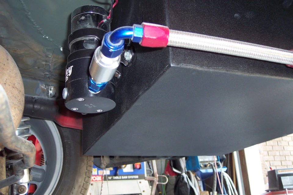

+2 on Holley blue. I've got that on my setup, works great. Noisy, but great. I mounted in on the spare tire wall, under the car, right in front of the differential. Also, buy a good 1.5" autometer gauge so you can dial that pump to about 7psi for your Holley carb

I sumped a new stock style gas, tank using a sump from cjponyparts. Works well, I can drive with very little fuel with no issue . I bought a new tank cuz no one wants to weld a used tank

As for the gravity feed issue, just be sure that the pump is as far back as you can get it, as low as you can get it. If you are using a early model tank that already has the proper pick up for a carb'd engine, then the tube style pick up will only be good for so much before power demand exceeds fuel supply,...( something like 350-400 HP).
