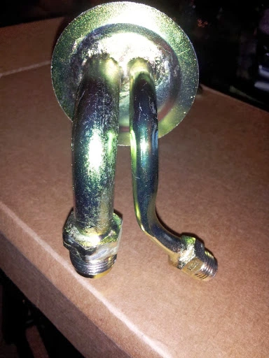

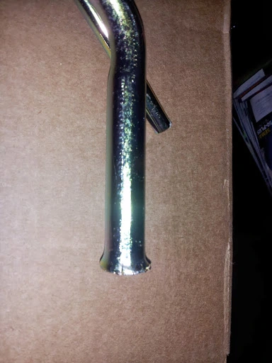

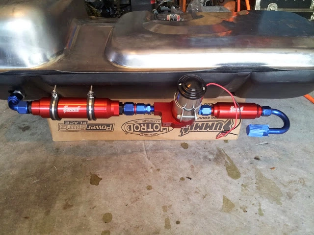

I am converting to a carb and I struggled with this a little as well. I thought about using an 85 pickup, but I didn't want to run a rubber hose in between the pump and tank and the factory lines are pretty small to begin with. So I bought a Granatelli pickup that had AN fittings, but it was junk. Crappy welds and the bottom of the pickup tube was cracked. I sent it back and decided to go big or go home! I didn't want to upgrade the fuel system later and this setup should be good for a lot of HP. Glenn's Performance sleeper tank with 12an fitting, 12an pre-pump filter, Aeromotive pump, 10an filter after the pump and 10an braided steel lines up to a Aeromotive regulator and Russell carb feed lines.
Granatelli pickup=dookie
New setup
