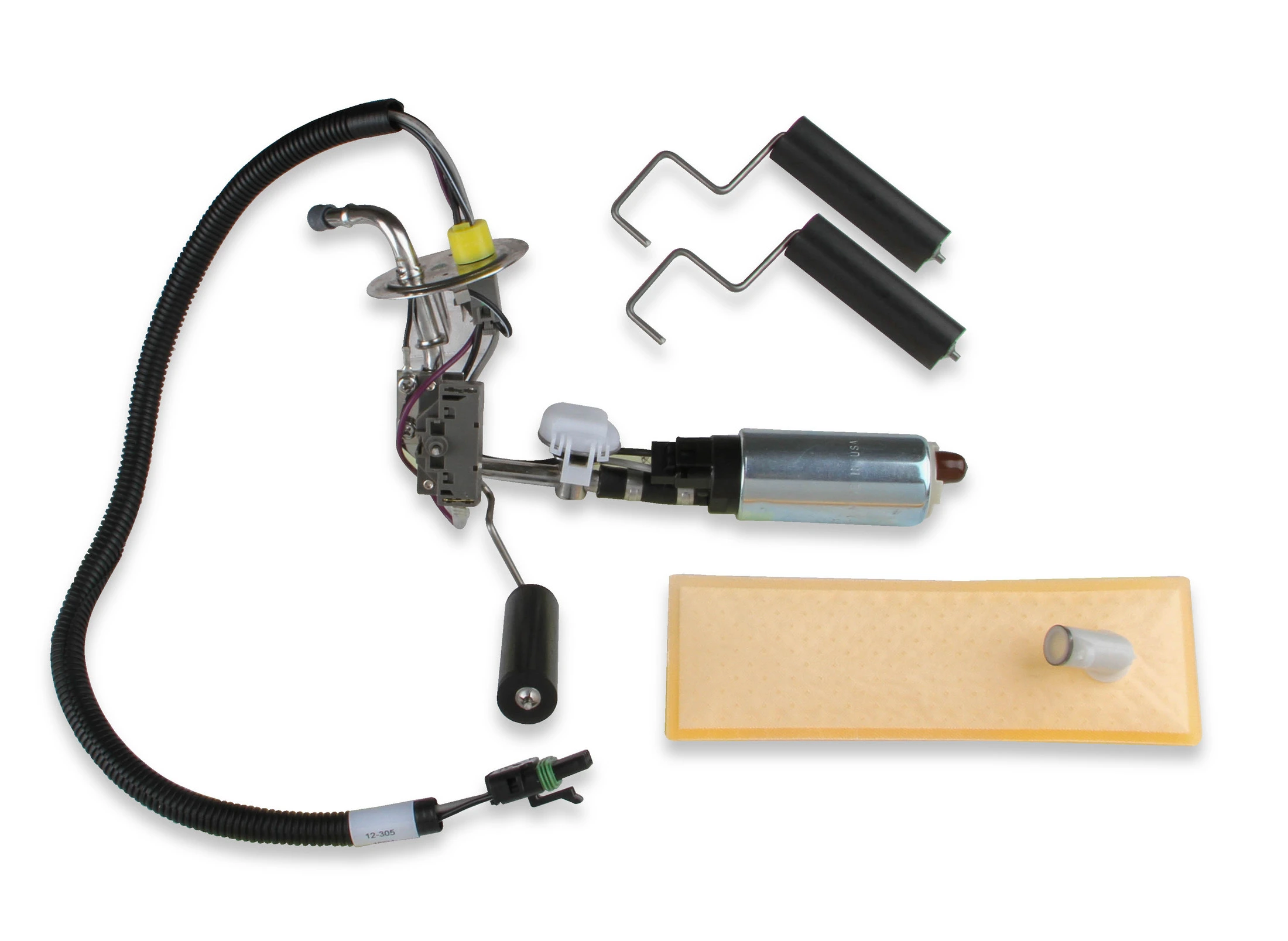

My inspiration comes from this setup:
https://www.holley.com/products/fue...uel_pumps/muscle_car_efi_modules/parts/12-305
This unit will not work, because I still use carburetor and it is high pressure EFI application and for 1gen Mustang tanks.

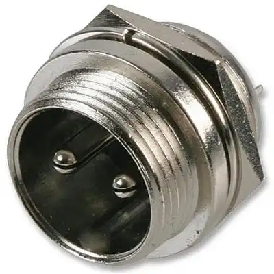

You're asking how to run wiring through your exisiting pickup to get to the fuel pump? I'm not sure how one would go about that honestly. Maybe there is some kind of bulkhead connector that could be used where you could seal the housing vs trying to figure out how to seal a pair or wires going through a hole. I'm thinking something along the lines of this:
I'm not sure if there's anything available that's small enough to incorporate it into the pick up assembly, but you could run extra wire in the tank and mount something like this separately next to the pickup. Of course that would probably necessitate the use of another connector inside the tank to connect the pump to this setup so you could remove/replace the pump as needed.
