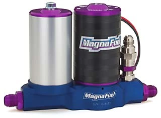

or you can look for a pump with a built in bypass.I have a Product Engineering pump.its similar to this one and maxes out at 36 psi.The silver fitting runs back into the tank,less hose and $$$
