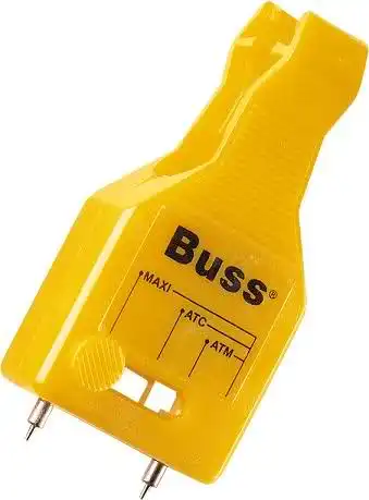

To test the fuses I used a yellow fuse tester and the key was not in the car. I also visually inspected them and they all seem fine. When using the test the green light came on for all of them, so that means they were fine.

Here's the fuse tester I've been using:
It has a small green LED on the other side that will light up when the connection is complete I guess. It's pretty much the basic one you can find.

I understand about the fuse tester now. It has a battery and a bulb (or LED) inside. If the two probes are shorted together (such as by the two terminals of a good fuse), a connection is made between internal battery and bulb/LED, and it turns on. What it doesn't tell you is if power is reaching the fuse from the battery. Some circuits are double fused, plus there is the "fuse of last resort" (the fusible links).
If there is a Harbor Freight near you, they sell a cheap (but good enough) digital multimeter for ~$3. Probing each end of the fuse, with the black probe connected to chassis, will tell you if battery power is reaching the fuse and passing through it OK. You can use the resistance (ohms) scale to test both fuses and circuit breakers (the fuse tester can't readily test breakers unless you can adjust the probes to match the spacing of the breaker terminals).
