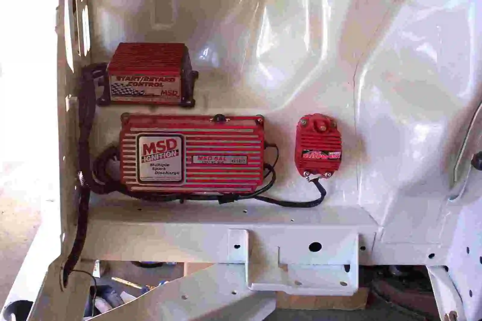

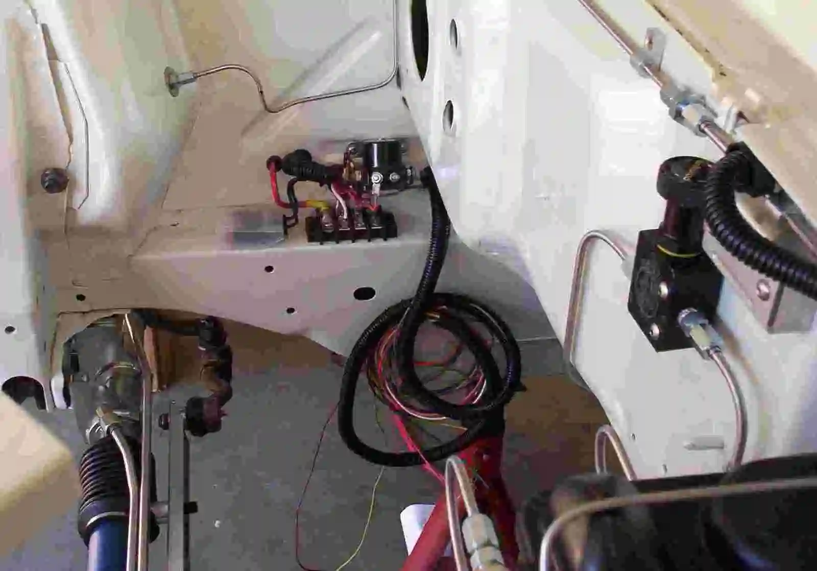

I bought the stock Painless harness and 14 spools of 14 Guage all colors of the rainbow and systematically, started in the trunk, added to the harness as I required. It worked out very well.....with the exception of single speed windshield wipers.....a little electrical data missing on this one.
I highly recommend the ~$600 that it costs. Wiring an entire car without some REAL GOOD planning, understanding, and expereince, will haunt you forever. I'll bet that doing one yourself....would even cost more.
ALSO, I modified where wires go and how they are routed. See the picture below. 99% of all wiring forward of the firewall go through the firewall and into each fender. I omitted the ugly mess of taking wires from high to application. All my engine connections come from behind the engine, making for a much cleaner engine bay. See attached. Note the billet blocks covering the old square bulkhead connectors. Also attached is where/how I mounted the ignition components. (Battery is trunk mounted)
