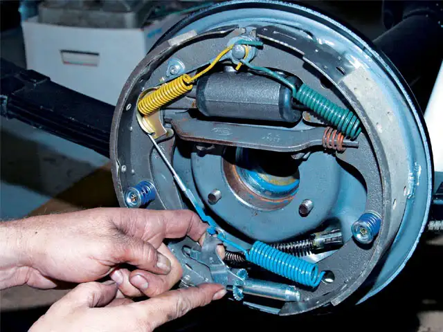

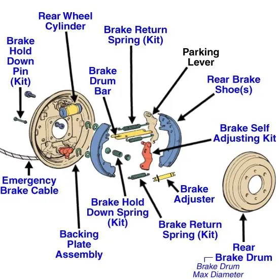

first let the tension off under the car where the cable connect to the ebrake.... then u got to pull the brake drums off and u can tryto unhook the cable with needle nose pliers its way in the back so it can be a pain to remove and dont forget to disconnect the rubber brake line on top that goes to the body

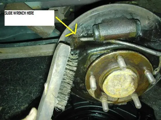

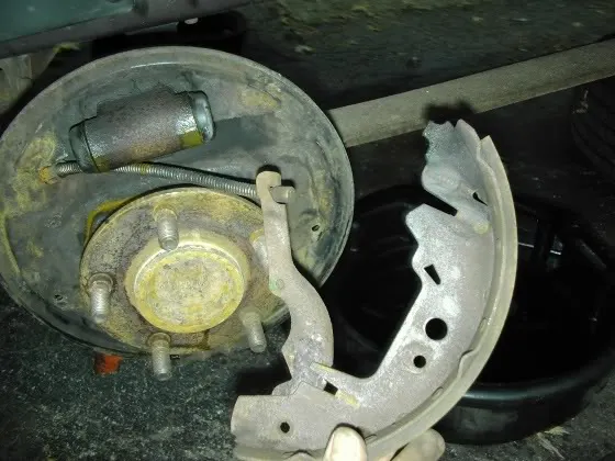

Take the drums off then take off the rear shoes.Remove the cable from the parking brake lever.After you have the cable off the parking brake lever slide a 1/2 wrench down the cable to where it locks on the backing plate and it will compress the end so you can slide the cable out.Hope this helps.
