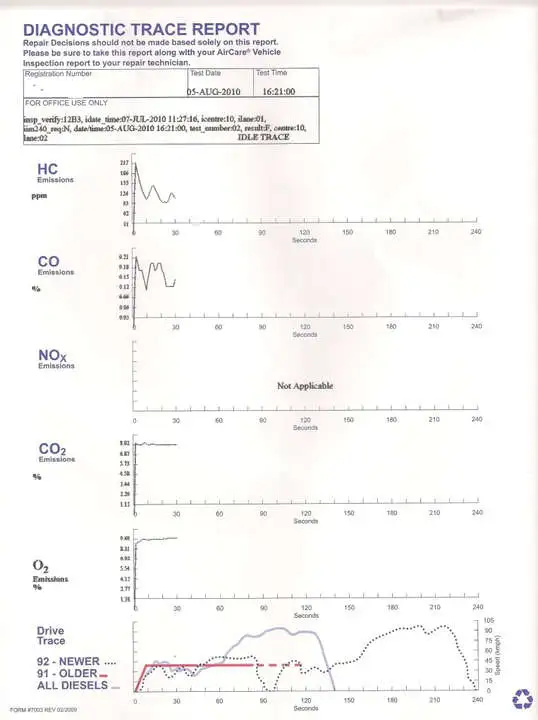

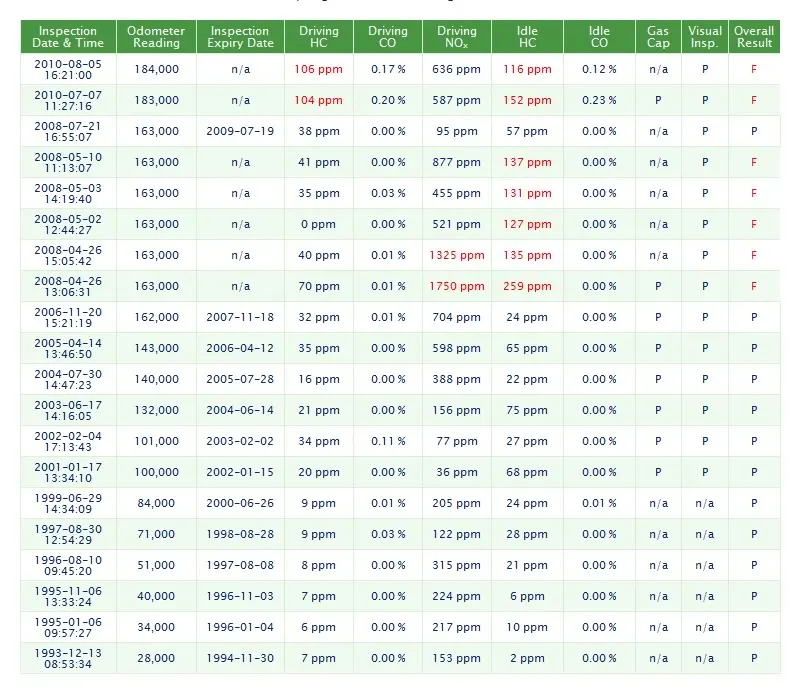

Hi there, i have a 1990 5.0 lx and live in British Colombia Canada, I have to pass my emission test by October 10th or else i cant insure it any more. So everything passes except my hydrocarbon levels. I heard hydrocarbons are caused by unburned fuel so i just swapped out my plugs for some nicer ones and cleaned my k@n air filter really good. thought id take it down just to see if their was an improvement. There was but barely. Heres my emmision results of the car since 1992, please let me know what you guys think could be the problem. And the allowable amount is 82ppm at idle and 89ppm driving.
PS: I have only had the car since October '08 so i'm not sure what they did with the hydrocarbons last time.

Since the numbers have slowly crept up, I wonder if the o2 sensors have slowly begun to fall out.
Are they original?
Try running the koer codes and see what you come back with.

heres my print out they gave me, what do you think? the first page is idle the second is driving.

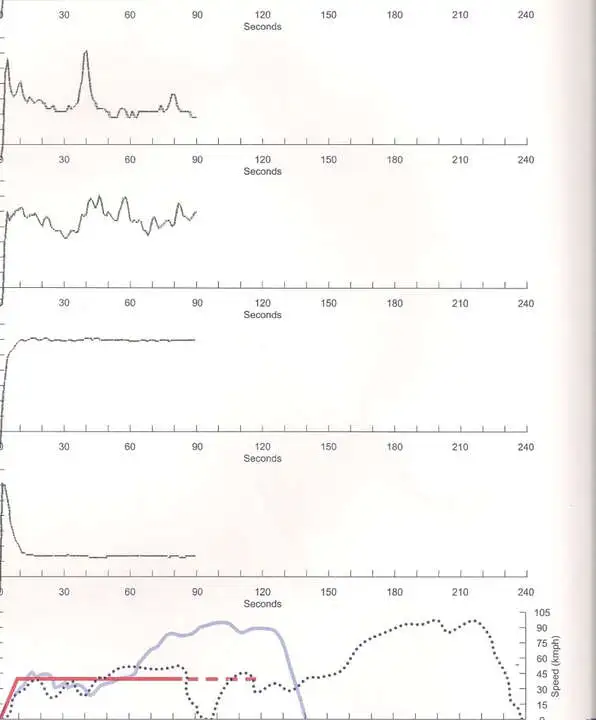

the second picture is cut off it goes, HC,CO,NOx,CO2, and then O2.

your print outs are so different than ours
however, lets make sure i'm reading this right...
your o2 levels are at 9% right? and you have high HC's....
now I'm NOT a smog tech, but my father is, and that's why I know a little. I certainly won't advise you to spend hundreds on cats, but I'd bet that's the problem. If you know someone else with a stock h pipe, try trading them and then smogging your car.
at 9% oxygen levels, the cats aren't using the oxygen to reduce HC...if the cats were doing their job and functioning properly, your o2 would be close to 0.

and for the second page, that spike in the begining is up at 30 and settle at about 5
