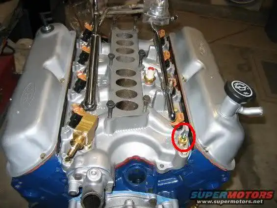

I presume the coolant level sensor is in the overflow tank, often is. Obviously that didn't work for you, if you have one (I don't on my car). The temperature sensor is one of the two sensors in the lower intake in the front of the engine. One's for the computer, one's for you, I don't know which is which. It's right on top, I'd have to check and see how hard they are to get to. I think you can probably get your socket in between the distributor and the upper intake and pull them without pulling a bunch of other things.

Yep check this sensor on your intake , i had my gauge that had crazy movement, just cleaned it up and made sure it had good contact.
