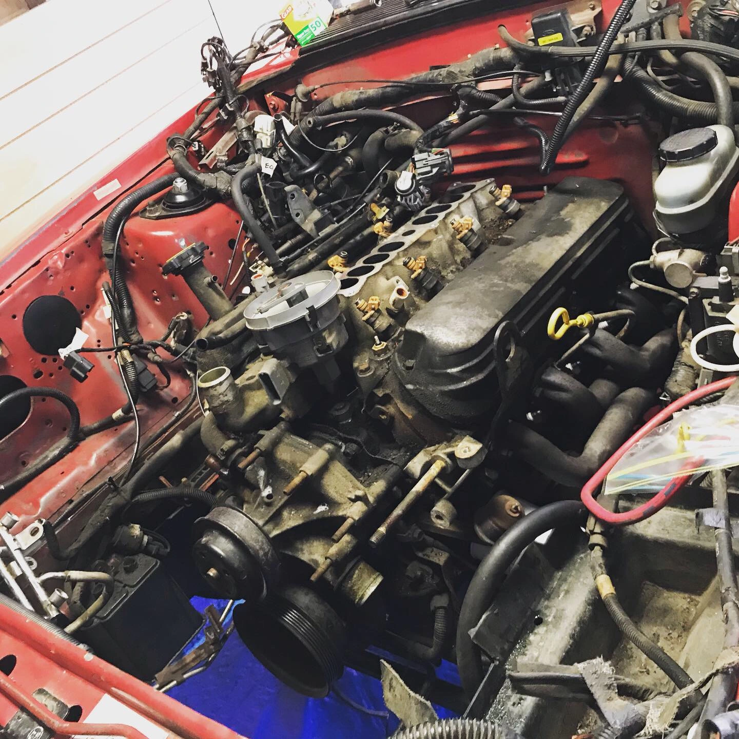

Thanks for all the input guys! I’ve starting taking the engine apart for removal. Current plan is to drop the transmission separately.

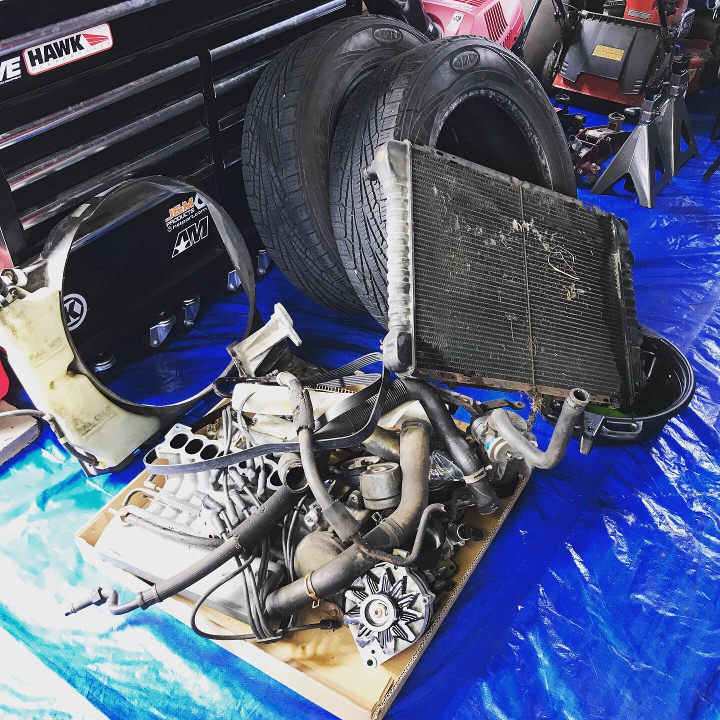

Took off all the accessories, dropped the exhaust, removed the first couple bell housing bolts from the top side of the engine. Thus far, cutting the exhaust off for better access has been the hardest part.

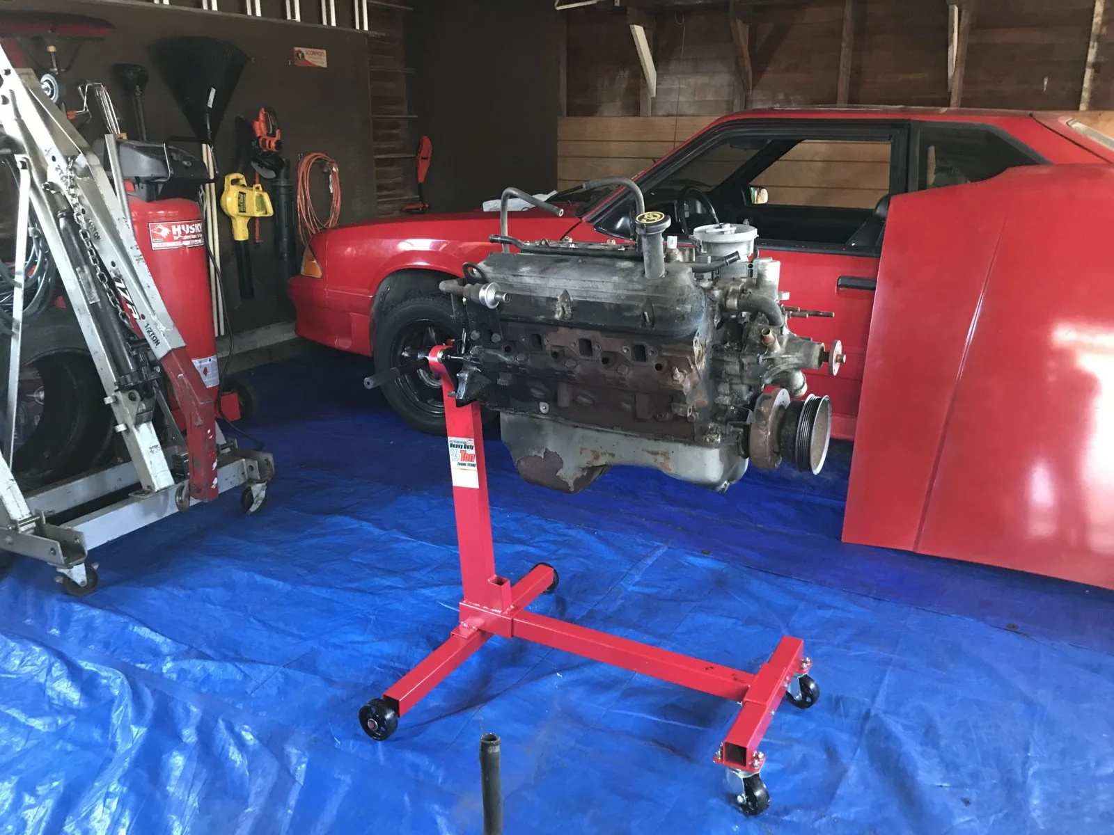

Had to split the work up over two different weekends, but the motor is out. Thanks for your suggestions guys!
