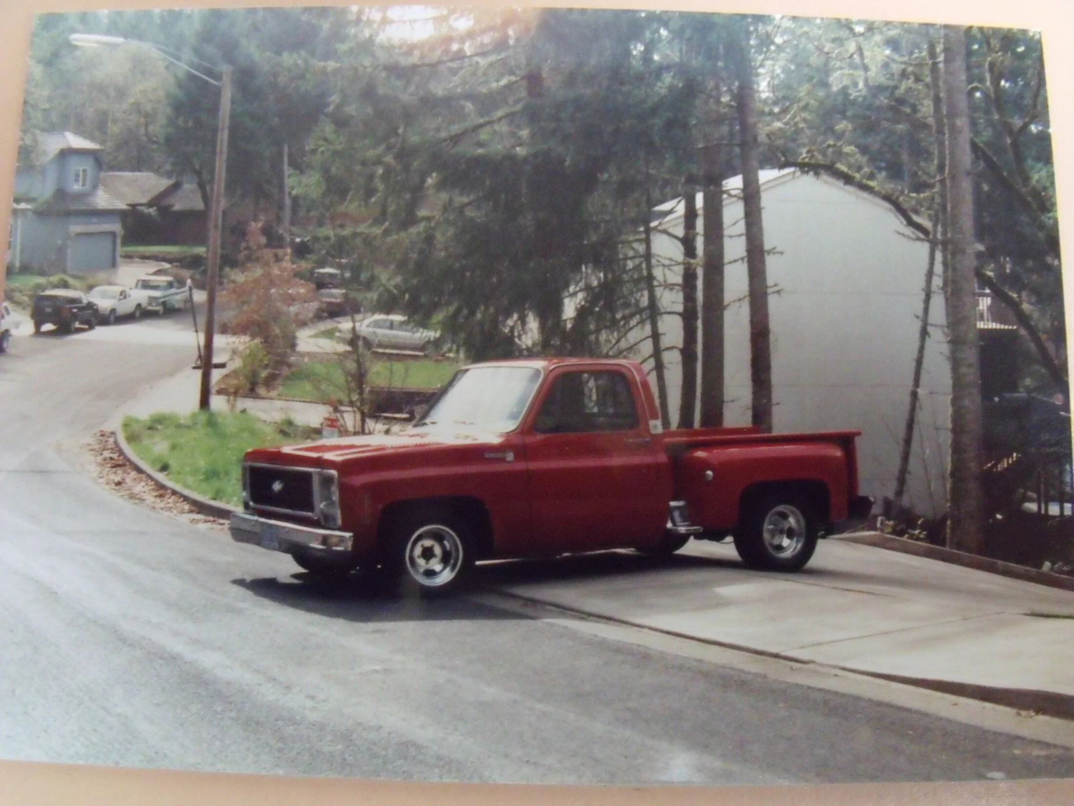

I bought this truck, not expecting to do a frame off resto, and it came with a louvered hood..
454. Turbo 400 that pulled boats and trailers all over... It never once even tried to get too hot....
Reactions: R82148V
