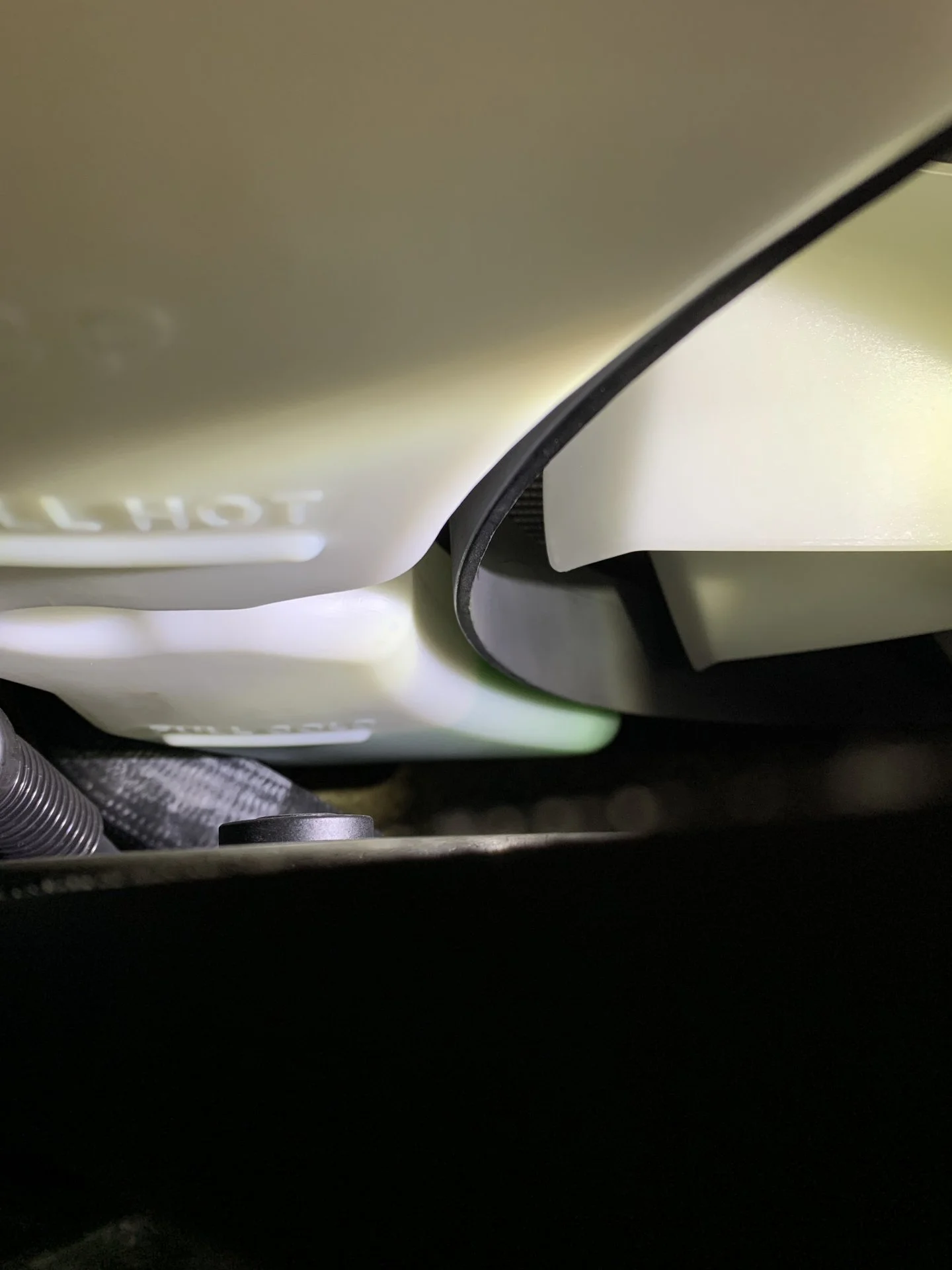

Im using the stock reservoir. it’s hard to see in this pic but when it’s cold it’s under the cold line. at temp it’s right above the word cold. it never gets any higher than that.

The marks are really meant for your extreme limits. In other words, cold engine should be above the bottom line to avoid sucking in air. When hot, it should be below the top line to avoid puking some out. Really movement anywhere between the two lines is fine provided your engine temp is fine.
