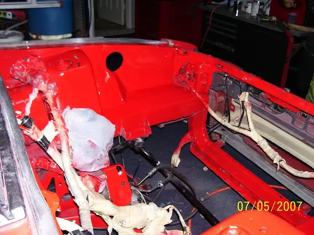

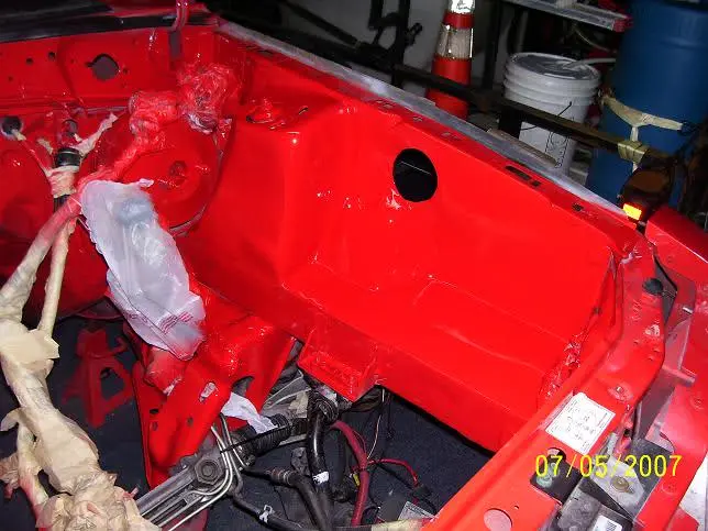

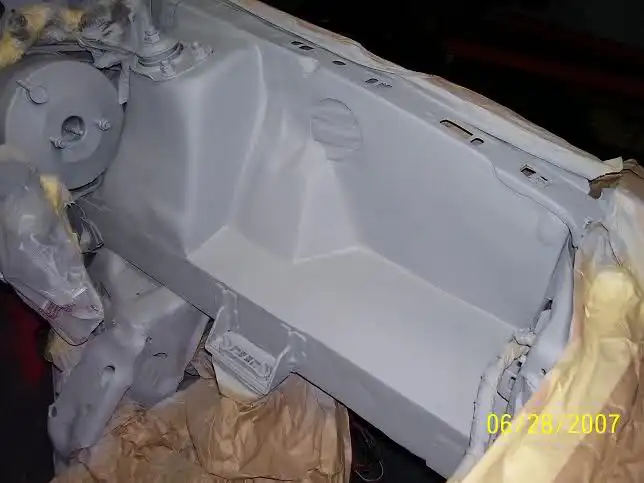

here are a few painted pictures of the engine bay, i still i have some cleaning up to do, again this was my first attempt at any type of body work. The lighting is pretty harsh
Hello all,
I have been giving progress reports on my cobra build as I go. I have been working on my car about 1 to 2 days a week, with no prior experience. I ordered my paint today and plan on painting Friday.(wish me luck)

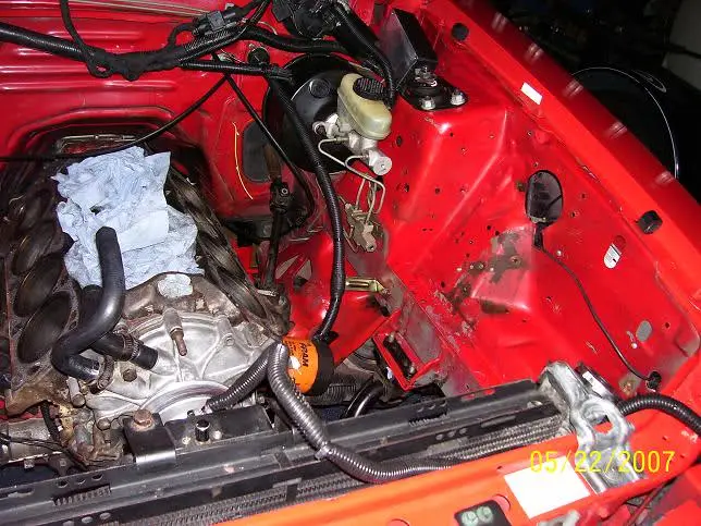

Here are a few pics of the after and before. If you want to see the whole car and a few more before pics check my prior threads.
Anyway I hope you enjoy, any questions or comments welcome. I know its not perfect, and here are the pictures.

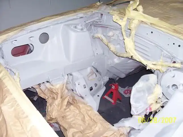

About halfway through i was wishing that I never started, there were many a night with metal shavings in my hair and ears from all the grinding that I was kicking myself for not just leaving the holes. Its a total pain in the butt, but requires more determination than skill.
Now that I am almost done I am glad that i stuck with it.

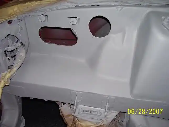

what did you fill the holes with ?
I have alot more on my plate the car i have i will need to repair rusted panels and remove good pieces from one car to replace bad pieces on another car..

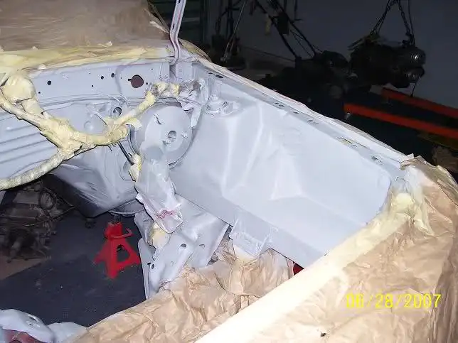

I tack welded the small holes, the bigger holes I filled by cutting various squares of sheet metal , holding them in place behind hole with a magnet and tacking them into place, I grinded down the welds, and smoothed everything over with body filler.
I sanded the body filler and primed it several times to get an even and smooth surface.
Just a ton of work
Wow, that is gonne look great. I have a lot of skill, but not enough determination like you said! I am doing a build up right now. Just sanded the enitre under hood area of my project, but I am painting over the holes.
