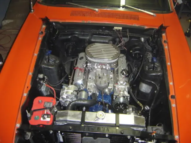

with some elbow grease, just wipe off everything thoroughly with mineral spirits then if you want to paint up the visible areas...mask, prime, paint!
for the grime on the engine you might want to take engine degreaser and a wire brush...see?
