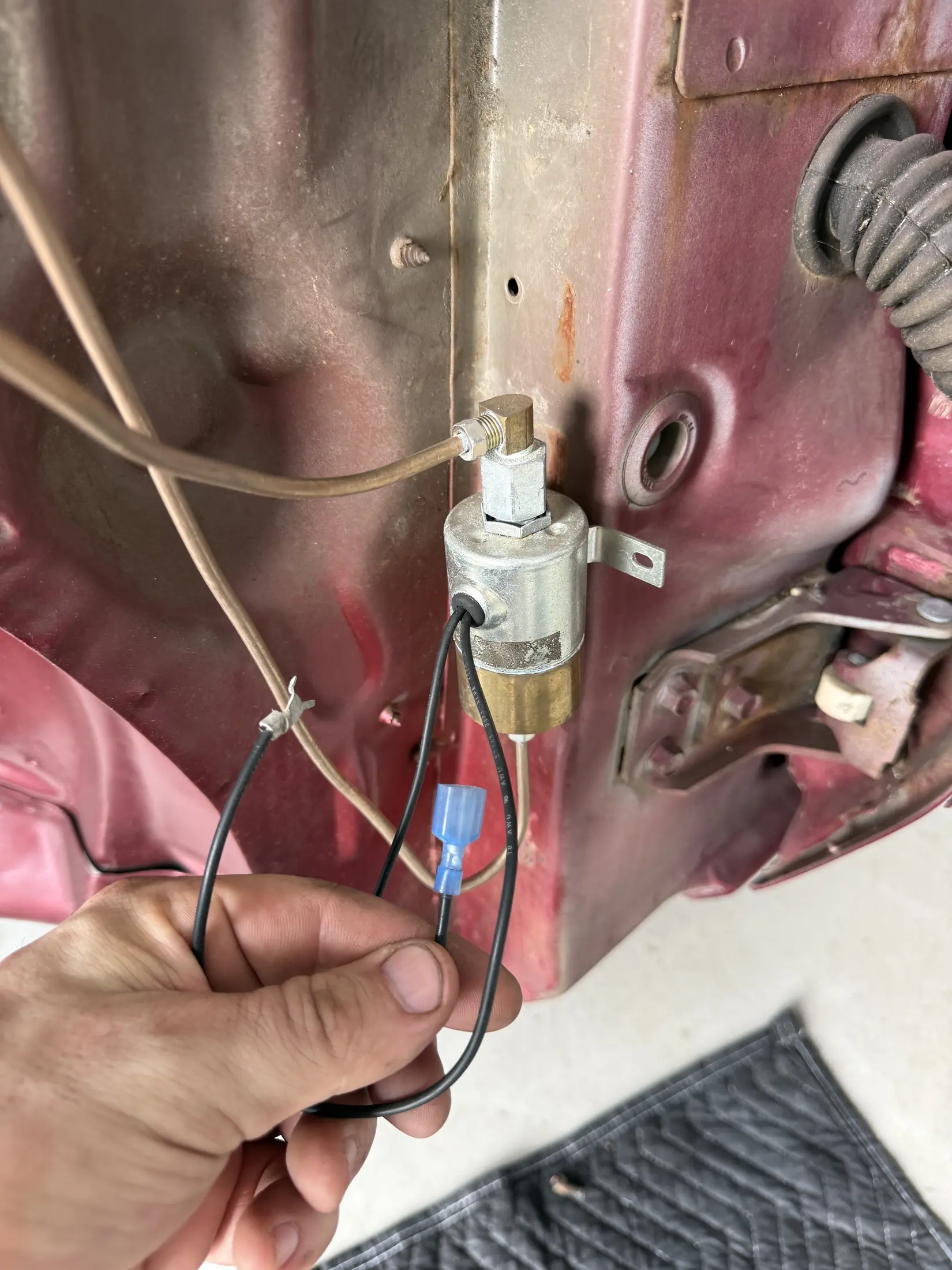

Hi! Just cleaning up some stuff in my 93 LX (previous 2.3 car) and saw this, wondering where I’m supposed to run these to. Thank you

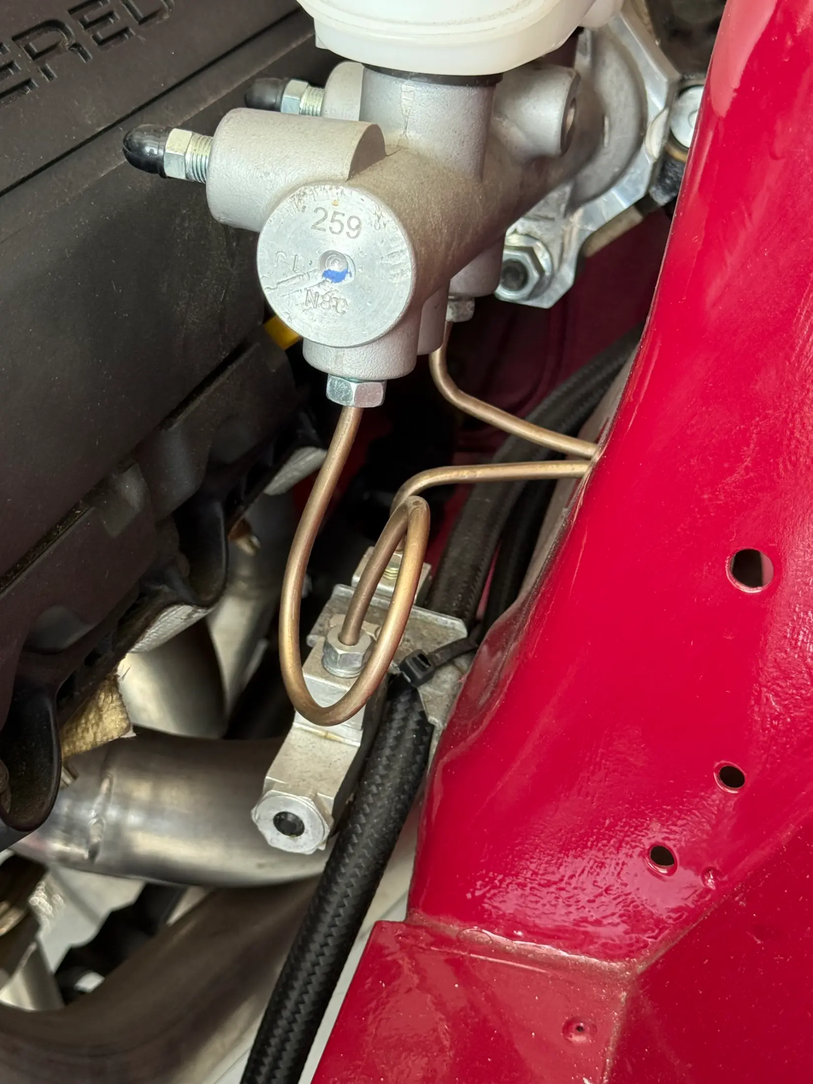

Gotcha! The car has a volvo electric pump on it and hydroboost conversion, can I get rid of these lines and the solenoid itself and then just cap off where its running into hydroboost? Don’t need linelock

So I am going to assume something here. Due to your user name being Coyoteswap93 I am going to assume that this is a Coyote swapped car and the "volvo electric pump" is a power steering pump that a lot of Coyote swaps use.
If you are referring to the lines that go to and from the line lock then no you cannot just get rid of them and cap them off where they run into the hydroboost. What you can do is remove the line lock and tie those lines together. Those lines control the brake fluid flow to your front calipers so if you just cap them off you will no longer have front brakes. You other option is to remove the lines and build one new one so you do not have all the excess line.
