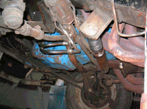

This is a pic of a '66, I don't know if there is a difference.
There is a couple other pics of it at:
http://www.randallsrack.com/Page3.html

Thank you for that pic. Do you have a pic of where it bolts to the frame rails? If anyone has that I would appreciate it. Thanks.
