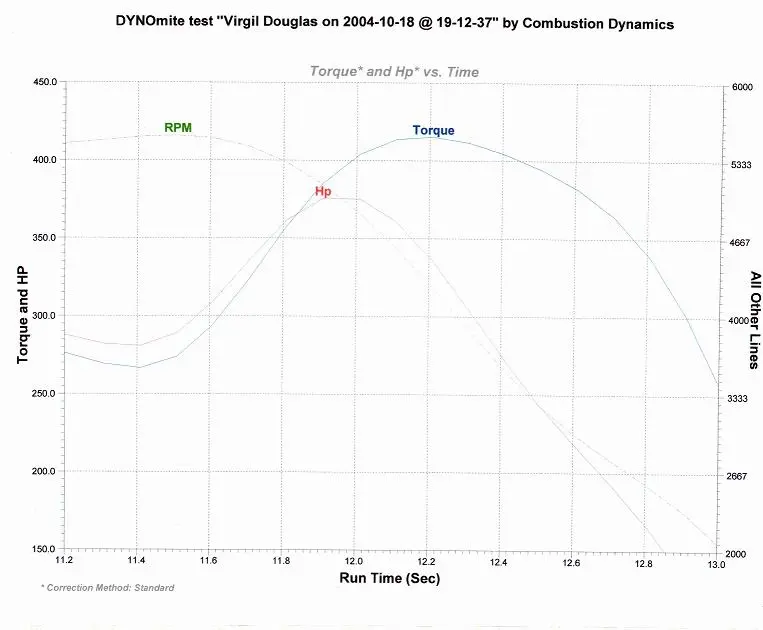

305 SBF 4.020 bore x 3.00 stroke World Windsor heads, Edelbrock Performer RPM Plus, Edelbrock AVS
750 carb, Mallory Comp 9000 dist, MSD 7
Out of the box it made 317 HP 349 TQ, Total of 48 pulls, tuning after each pull. totaling 379 HP 415 TQ
Not that shabby.
