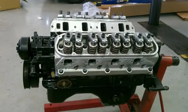

Give us some back ground on how you ended up with that combination. I'd say get a chip burned, but I think with those heads you'd be pissing into the wind. I'd try and get a different set of heads. You just don't have the valve clearance to make those work properly. I can tell just from the pictures that someone has gone ape with the port work. I wouldn't be surprised if those heads aren't flowing 315ish/215ish at .600". That's where I would start. I have no idea what an Autolite 3910 is suposed to be for. With those heads, you should be running a 3924 or a 3923.

I thought the heads would be to big but i would go with a charger later down the road, I didn't expect to have such a loss in HP in the mean time. I bought the heads from a guy who had them on a 408w. I figured bigger was better, but I'm guessing bigger in this case isn't better. I do have a set of GT40 iron heads that i bought and can bolt them up later in the week. I have some of the specs of the heads
Avenger Cylinder Heads/Ford Performance Solutions.
215cc intake runners.
Have 2.08/1.60 Manley Stainless Steel.
64cc chambers.
Springs are set up for .700 lift.
with 7/16th guide plates , screw in studs, and 1.72 roller rockers.
I was told the autolight 3910 plugs were the main plugs guy are running with the aluminum heads.
I also have a new set of blue top 24# injectors, I had read that the '94-95 GT and the Cobras use the same MAF and that the ecu has the program for the injector size. Is this tru? If so has anyone bought a cobra ecu and used it on the GT?
Your logic is correct on the Cobra computer, but I'm not absolutely positive on that one. the GT40 heads would work ok, but I'm not a huge fan of iron heads. Depends on what you want to do with them. The good news is those Avenger heads are worth a good bit of money. They aren't particularly better than any of the other big heads available today, but they don't make them anymore. That head used to be the cat's meow back in the day, and people pay big money for them. You could easily sell those and get a set of TF 170s or AFR 165s.
