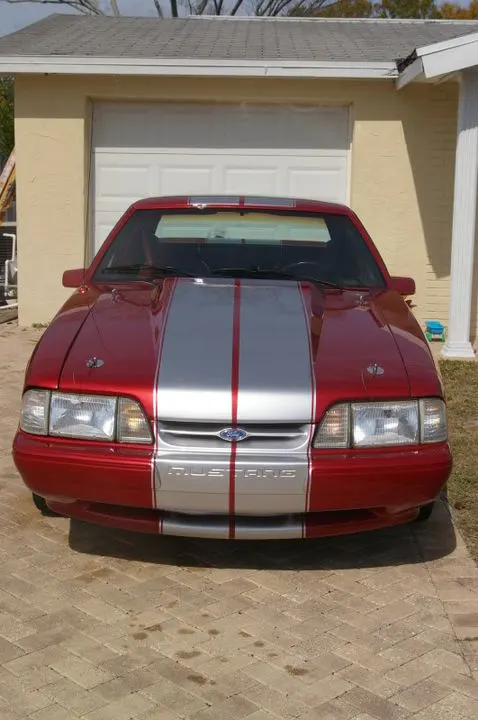

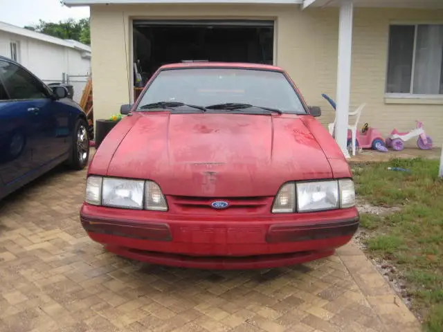

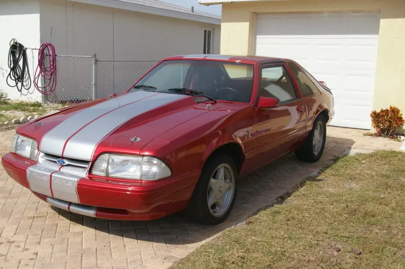

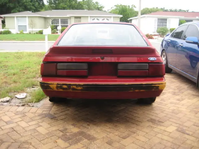

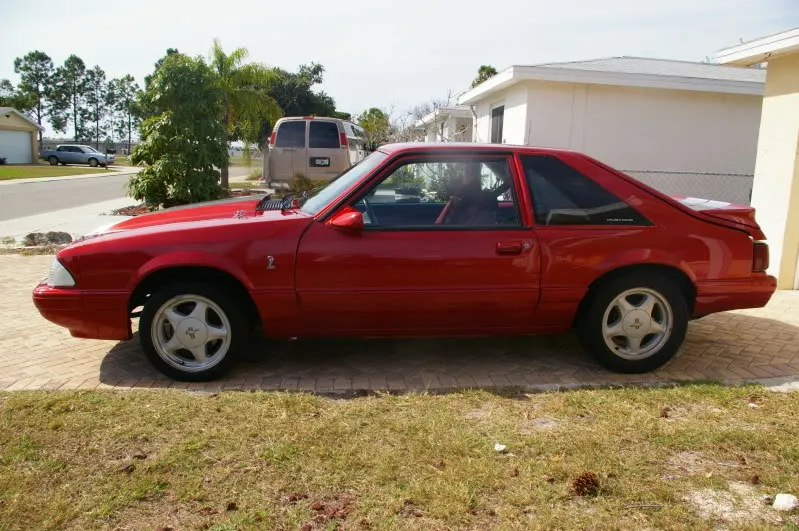

I have been looking for a cowl induction hood for about a month on CL thats going to clear the intake. I found one the other day and drove the 8 hrs round trip to pick it up, I also picked up a saleen front bumper and 24# injectors. It was worth the drive as I got all 3 for a GREAT price. My friend is doing the body work on the hood and bumper right now and should have it painted for me in the next few days. Here is a pic of the last mustang we painted. It wa a '90 fox. Bought it for $500 (yes it ran pretty good but the body was beat up). I didn't do anything to the engine minus a bbk cai. We painted it Candy Apple Red with an Orange Diamond Pearl. Came out pretty good.
