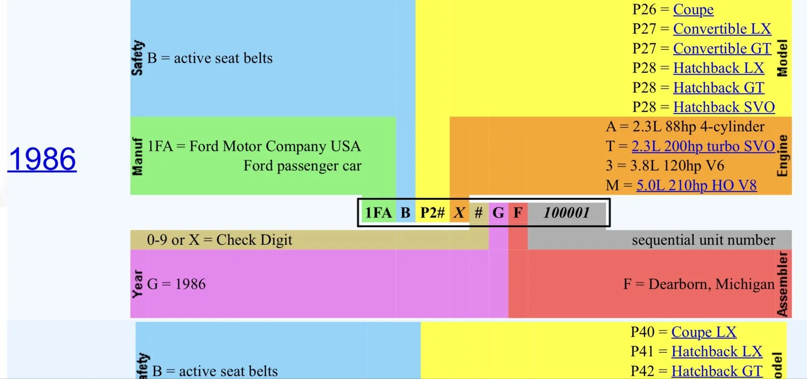

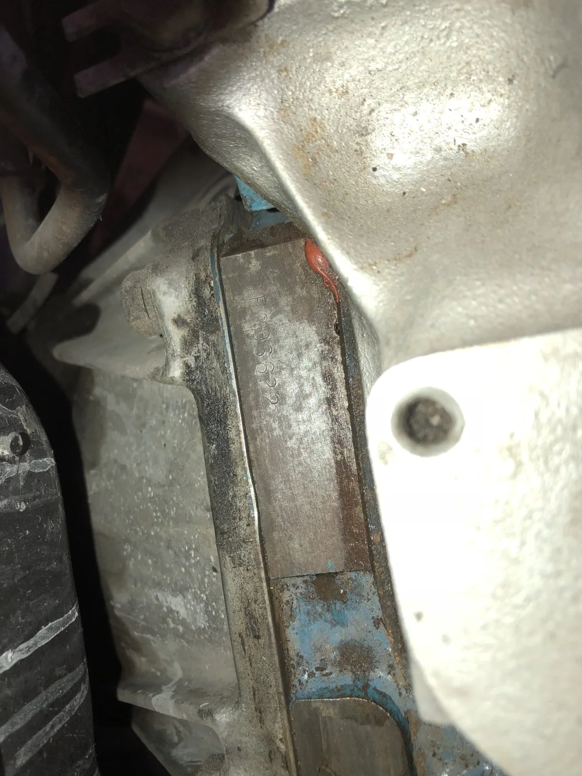

Thanks for the info! I’ve messaged the previous owner and he’s told me that it currently has a 302Ci (5 litre) V8 from a later mustang but he used the original intake manifold from the 289 engine! Mystery solved finally! I’ve checked for any more numbers on the engine and found a partial VIN stamped on the engine block in the middle of the V. The first letter is faded but I think it reads: GF296622 ... I’ve googled and researched what I can. I believe it’s a 5 Litre HO engine from a 1986 mustang. But apparently those were fuel injected yet mines carburettor? Any ideas?

Yes it is a 1986 and since it came from Dearborn, it was most likely a Mustang 5.0 HO. The 1986 engines had true flat top pistons without valve reliefs, so if you're lucky, they were swapped out. I was considering taking my 1987 HO engine and installing the top end from a 1965 289 on it. Hopefully your engine has the 50 oz. balancer and flywheel or flex plate installed.

I’ve checked the firing order today and found that it has the firing order of an older generation 302 engine not the 5.0 HO. So I’m wondering if it’s an older 302 engine that was sitting on a shelf somewhere in the factory and put into a 1986 mustang at time of production?
No. It's a 1986/87 roller block.
Firing order depends on the cam. Cams are easy to change, especially when an engine is rebuilt.
Intake manifolds and bellhousings interchange between older and newer blocks/longblocks.
