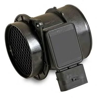

Pull codes and see if you have any, specifically for the mass air meter.
Also try "reclocking" your meter. If the pig tail is directly on-top of the meter then rotate it so that it's at say... 15* different from its current position.
It's possible that you're getting some dirty air turbulence over the mass air element.

No. Any time you run a mass of air down a tube, it swirls. You get vertices in the air flow. Sometimes with CAIs or Ram air kits, you create a condition where there's a turbulent spot of air hitting the sensor element.
Reclocking the meter means to rotate it. It'll put the sensor element in a different location. It's why you see so many OEM air meters with screens over the inlet.

Intermittent signal loss to MAF
