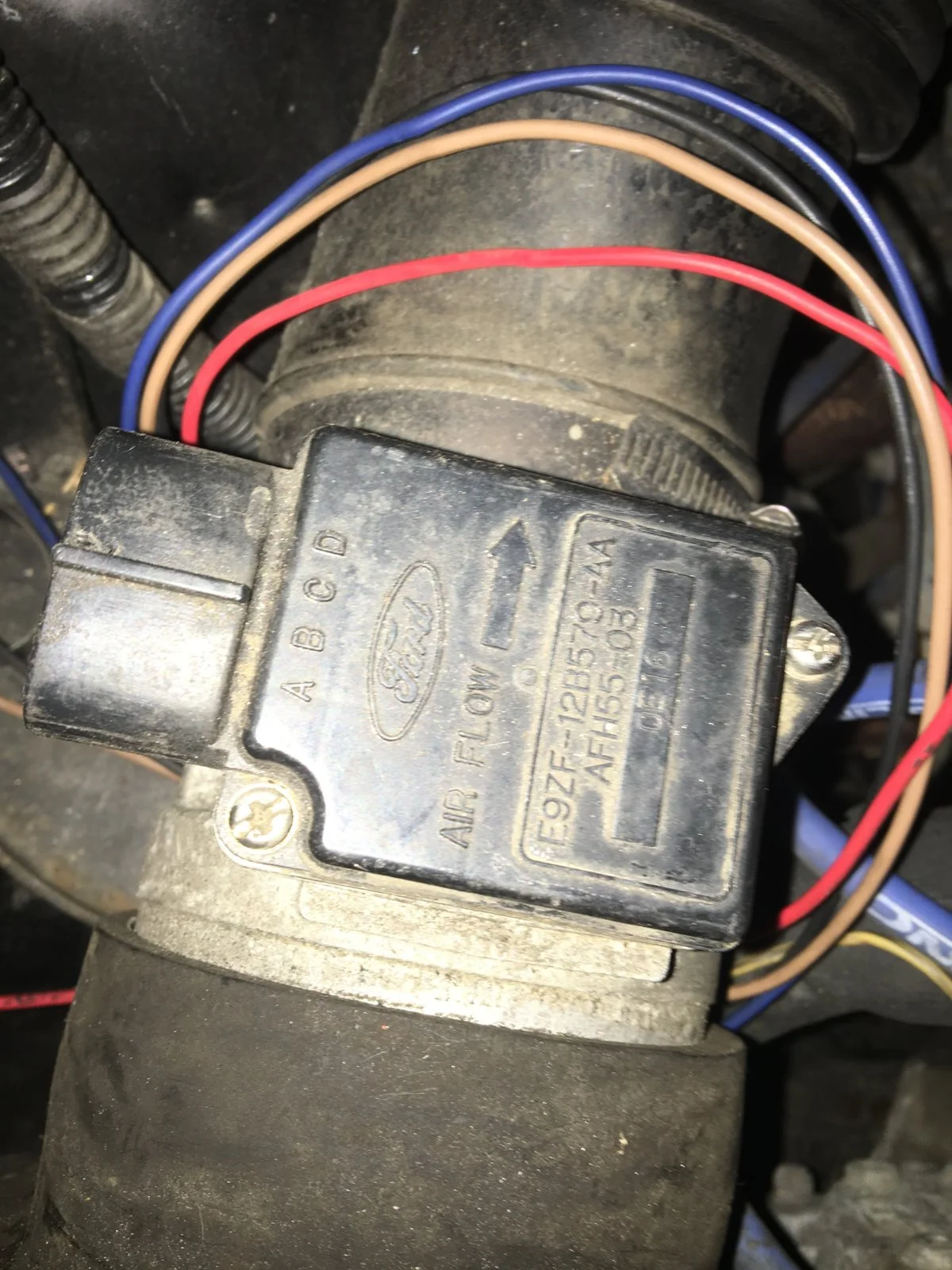

Hi I like I said I do not have a ECM. It had a 89 auto ecm in it which was fried. What I am asking is which one will work everything is stock as far as mass airflow and injectors go.What the person did before was put a reman 90 gt stock motor in a 87 manual. I’m assuming they figured a 89 auto ecm would be compatible. The wires from mass air flow were tapped into the pins on the ecm plug.
Loose the maf, get a bap sensor and a sd computer. Make sure it still has 19lb injectors.
that would be a start.
you should also get a ford assembly manual for wiring diagrams. There may be more wiring issues the previous owner did.
