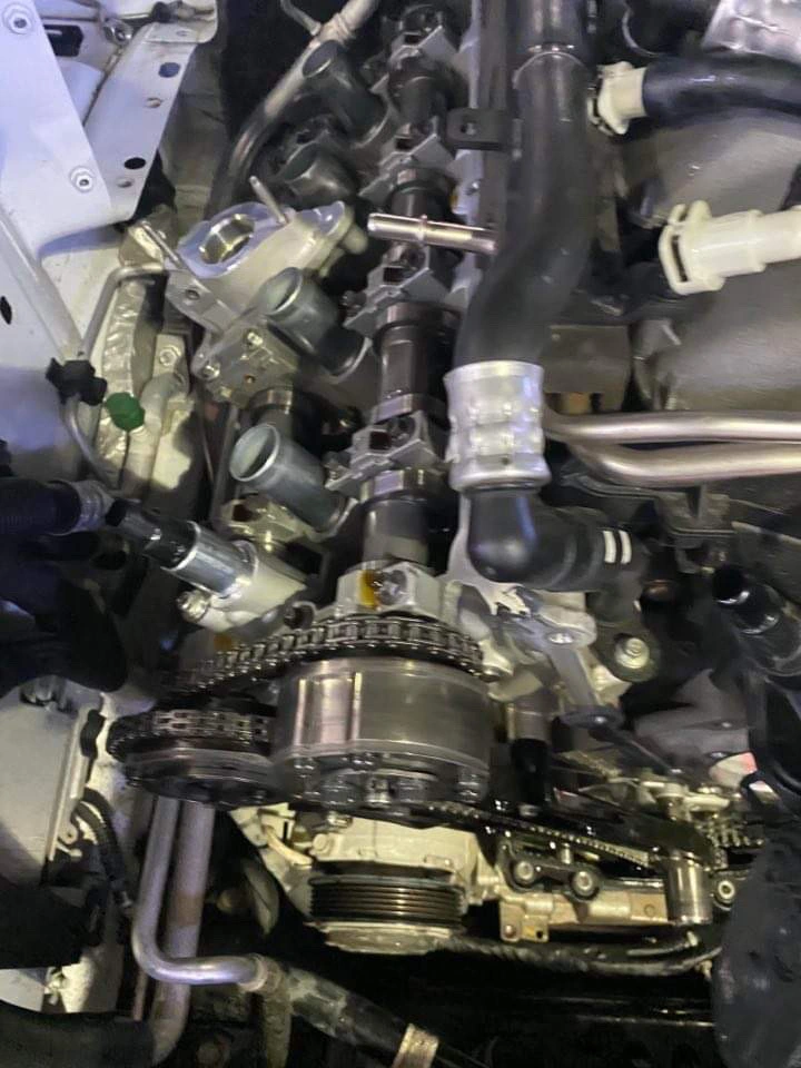

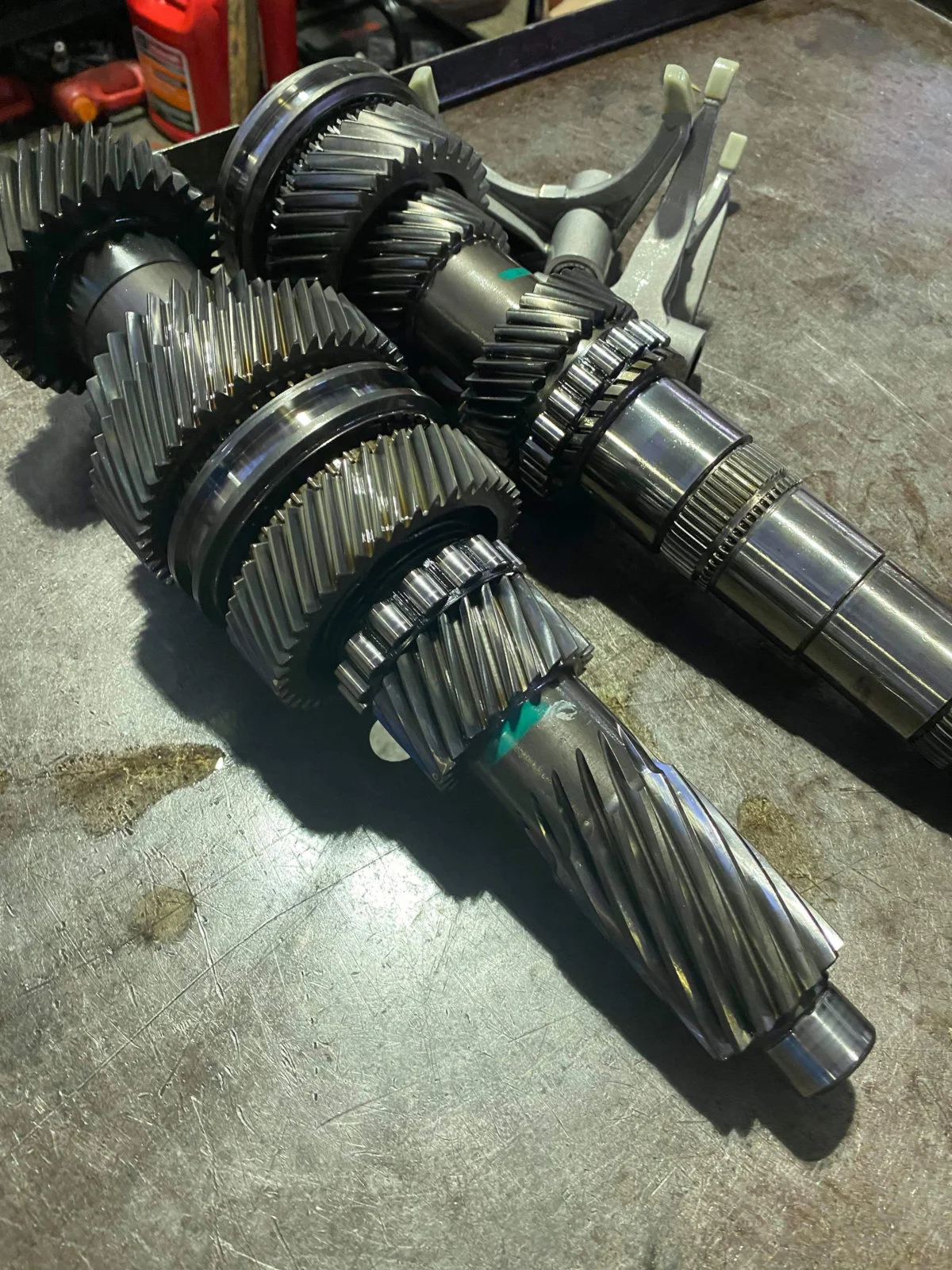

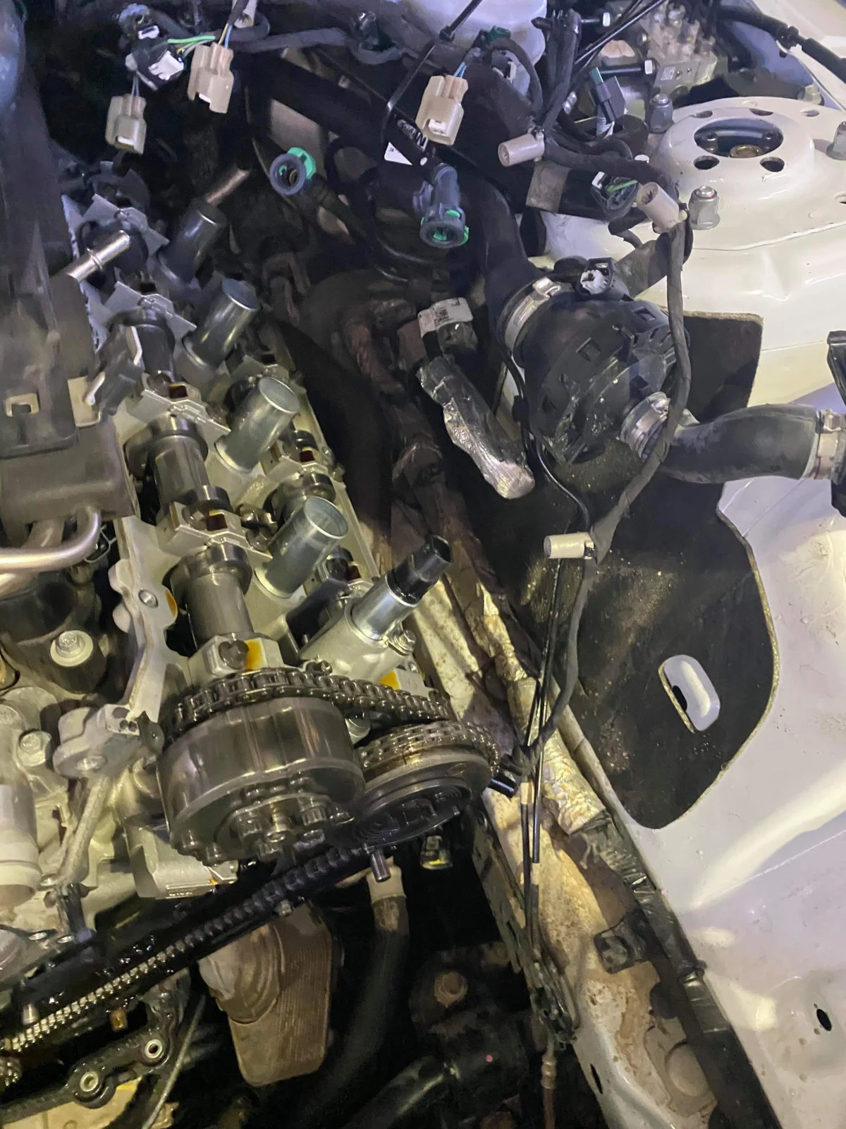

I purchased a mustang gt 2018 with 14k miles and my tuner told me that I should take it to Ford because it had a noise on engine between 1500/2000 rpm that was not normal, the transmission started to gridding shifting from 2 to 3 and to 4 above 5k rpm , I have replaced the clutch by one from Macleod twin disc with aluminum flywheel, same thing with new clutch after a week and some pulls it didn’t shift only from 3 to 4 gear right above 2k rpm , went to Ford and it is being fixed has I’m writing this , transmission rebuilt and new engine phasers .. all covered by warranty.
so if you guys have a 2018 gt with that Weird noise take to the Ford dealer cuz it’s the phasers. And the trans issues it’s due to aluminum forks .

Take the car to your ford dealer again and tell them to fix it . I’ve just picked up my car from ford dealer because of the exact same noise, it’s the cams phasers they replaced them on my car and rebuilt my trans has well . Common issue on 18 mt82 mustangs Phasers and transmission. Don’t know why 19 still come with the same problem .
A guy I bought my RTR grill from a few months ago had 2 engines replaced on his 18 5.0 standard shift. They bought it back when they found the input shaft to his transmission was bent. Make Ford fix it....keep taking it back. He went through the same thing. I'm an Advanced Level L1 certified engine performance tech. This noise is a known issue at Ford and can easily be confused with DI tick...the debris from the issue clogs the camshaft phasers and lessens the oil going through them causing more wear. Not all 5.0 mustangs have this issue. Break in is especially important with these engines.
