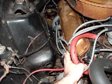

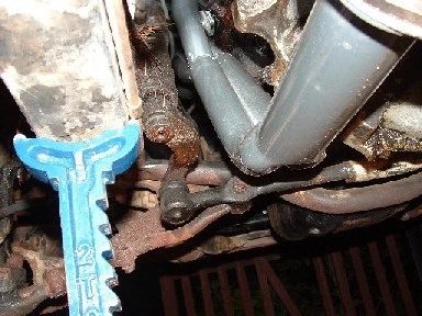

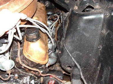

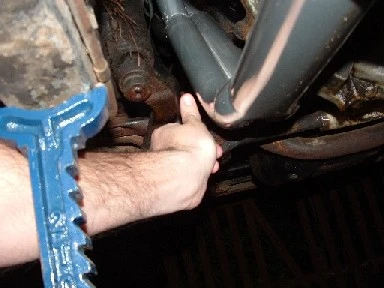

see pics
Here are some pics...
you can see the engine shifted by room on drivers side, and touching on pass side...
you can see 2 shots from below wheels straight.

notice
Well if you notice my engine is not centered...it is more to the pass side. It is actually touching the inner fenderwells on the pass wide. I am sure that if I centered it I would not have much room to turn either...
So now I am wondering how mine will act once centered...
