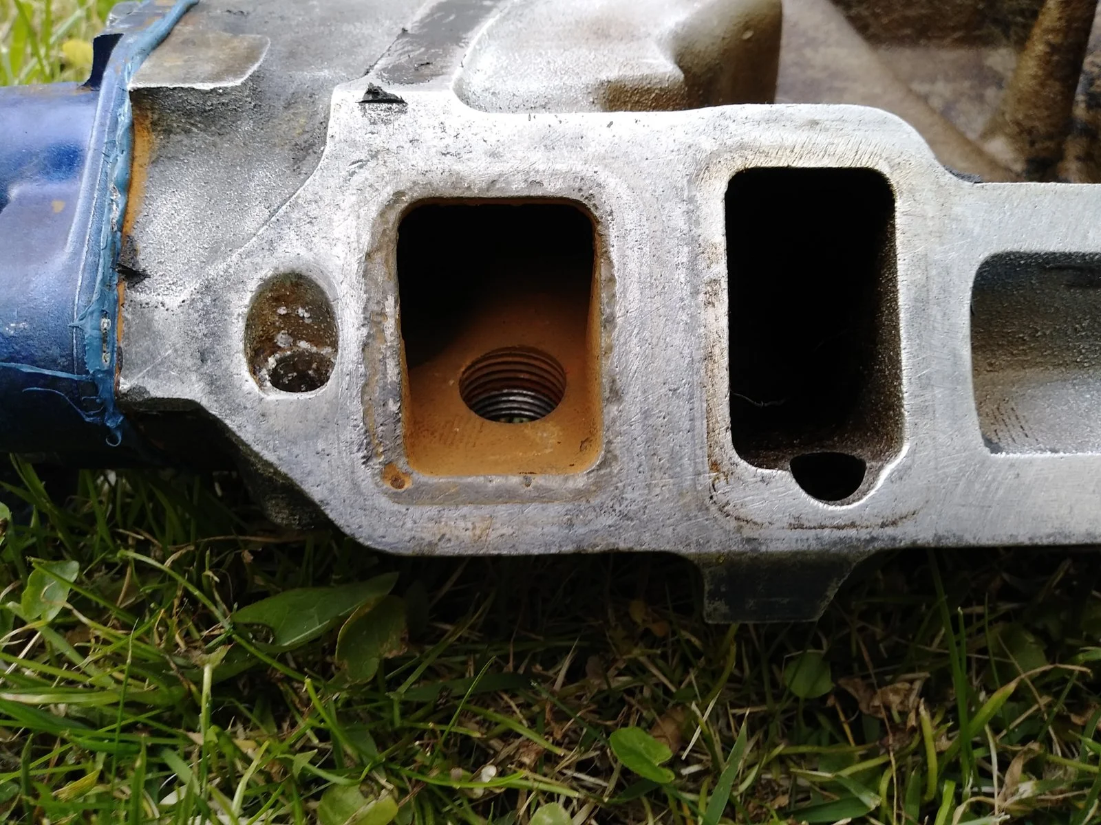

No pics of the ports but I will and post them to this thread.

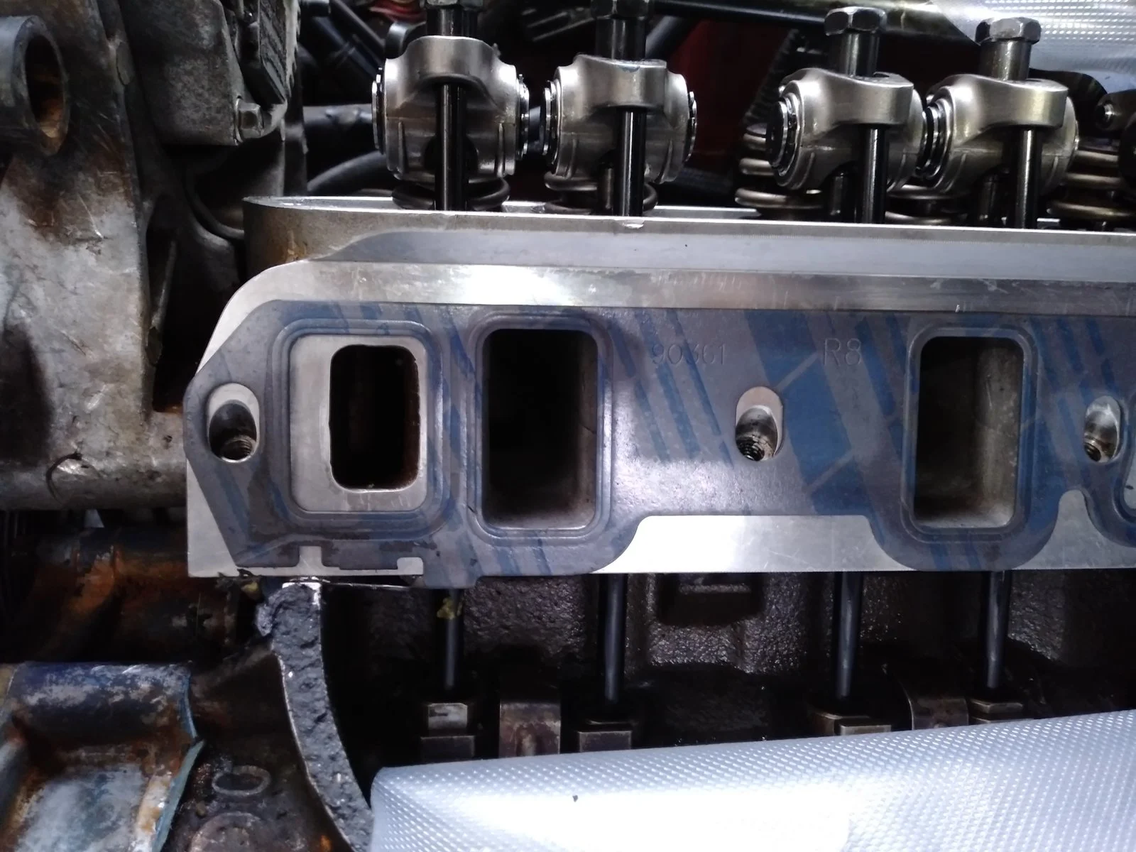

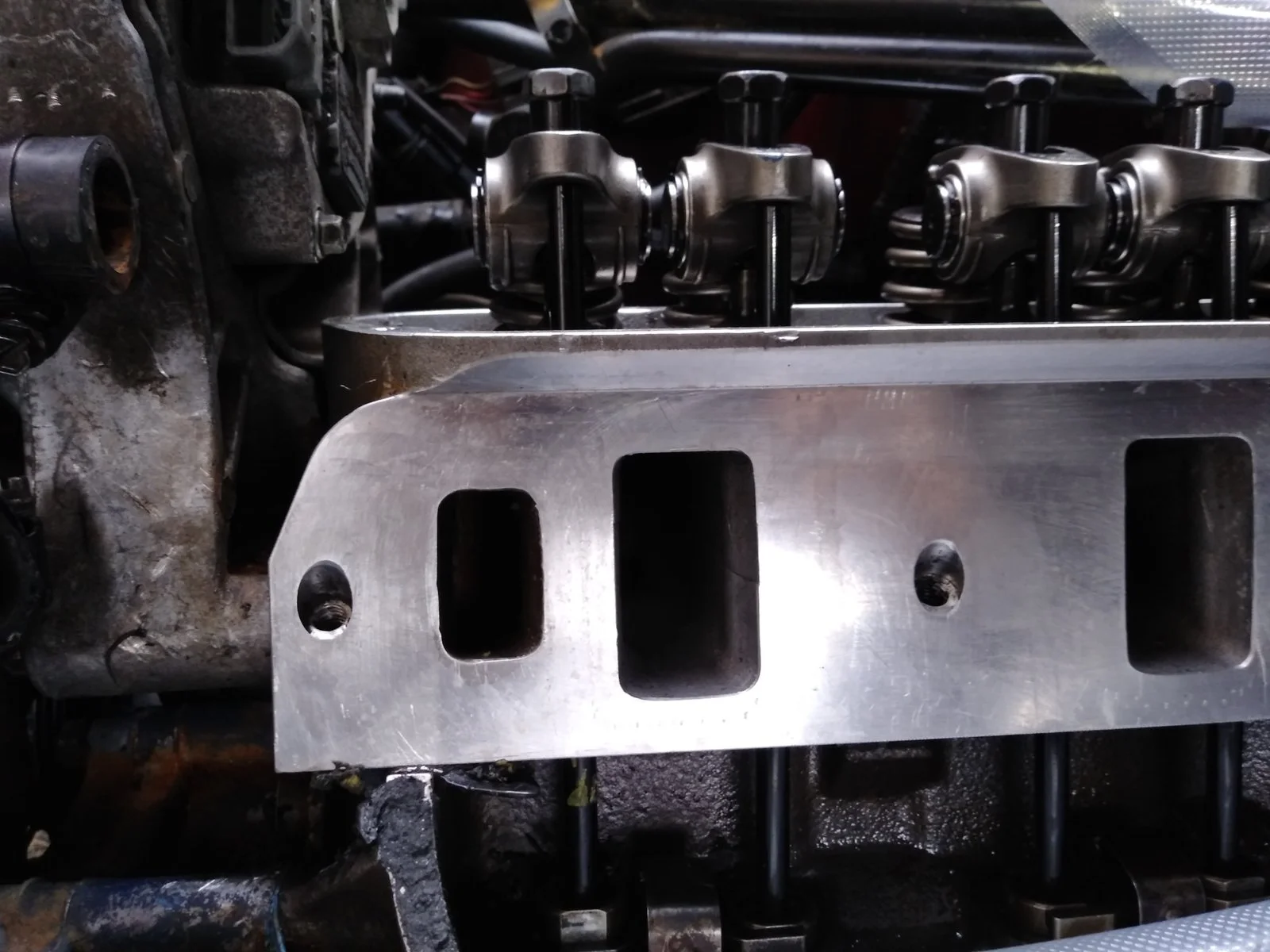

See attached pics.
BTW it took me 3 hours to get the heads clean in the attached photo. I had used the 3m weatherstrip adhesive, Big mistake, from now on ill just use the high tack or indian head.
In the photo of the manni gasket on the head youll notice that the gasket is not in the head gasket tab, If I locate the gasket in the tab there is only like 1/16" of gasket above the top of the intake ports. I use the right stuff on the china rails so I dont think moving the gasket will cause a sealing issue at the rails as im sure it squishes beyond the rail to the port and starboard.
Those gaskets are 9334s and not the ones I will use when I try again although
I do like the 9334s but the port openings are a tad narrow for my ports. I did find a ground strap off , its the one going from the frame to an exhaust manifold stud and also in regards to grounds I do not have one for hego ground in the injector harness like the older fox mustangs do. I will have to reference my EVTM catalog and find out why.

well after 4 tries to seal the lower intake it appears I finally got it to seal. This time I adhered the gaskets to the lower intake with some high tack, I know that is not the way your supposed to do it but I figured it was worth a try. The car will stay running and the only think going on is a pretty good surge. Now I will try to troubleshoot the surging using the surging idle checklist but the backfiring in the intake is completely gone and the throttle response is great. Gotta change the oil now as im sure some water has gotten into the crankcase due to the 4 failed intake manifold installs. I really think that the surging can be corrected with a tune.
The only detraction of the successful intake install is the fact that I used some 9334 gaskets which have port openings a tad small for the ports in my heads but they fit over the gt-40 intake fine. BTW those gaskets were used on one of the previously failed attempts but were in good shape, not sure if they were compressed but they are working. I will probably get some 1250s gaskets down the road since I now have a method of installing the lower that works.

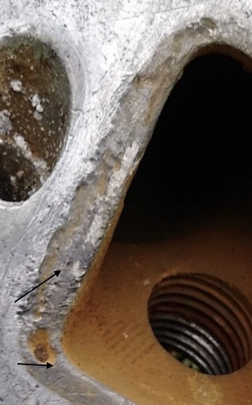

Observation: Intake’s seal surface is in an advanced state of corrosion, degradation, pitting, deep file marks, with an earlier failed attempt to use a filler putty like Devcon, JB Weld, etc.. Visually, difficult to discern whether actual welding was attempted.
Those fillers work fine to hold parts in place, repair threads in a pinch, repairing correctly once possible, usage for repairs under stress within an engine is creating a time bomb. It blows under & that’s the end.
Little original surface area is now left for intake gasket crush for sealing reliability against 10-12 PSI of coolant pressure.
With everything going as they should for your setup right now, I’d suggest (at least) seeking out an alternative GT40/ GT40 Intake.

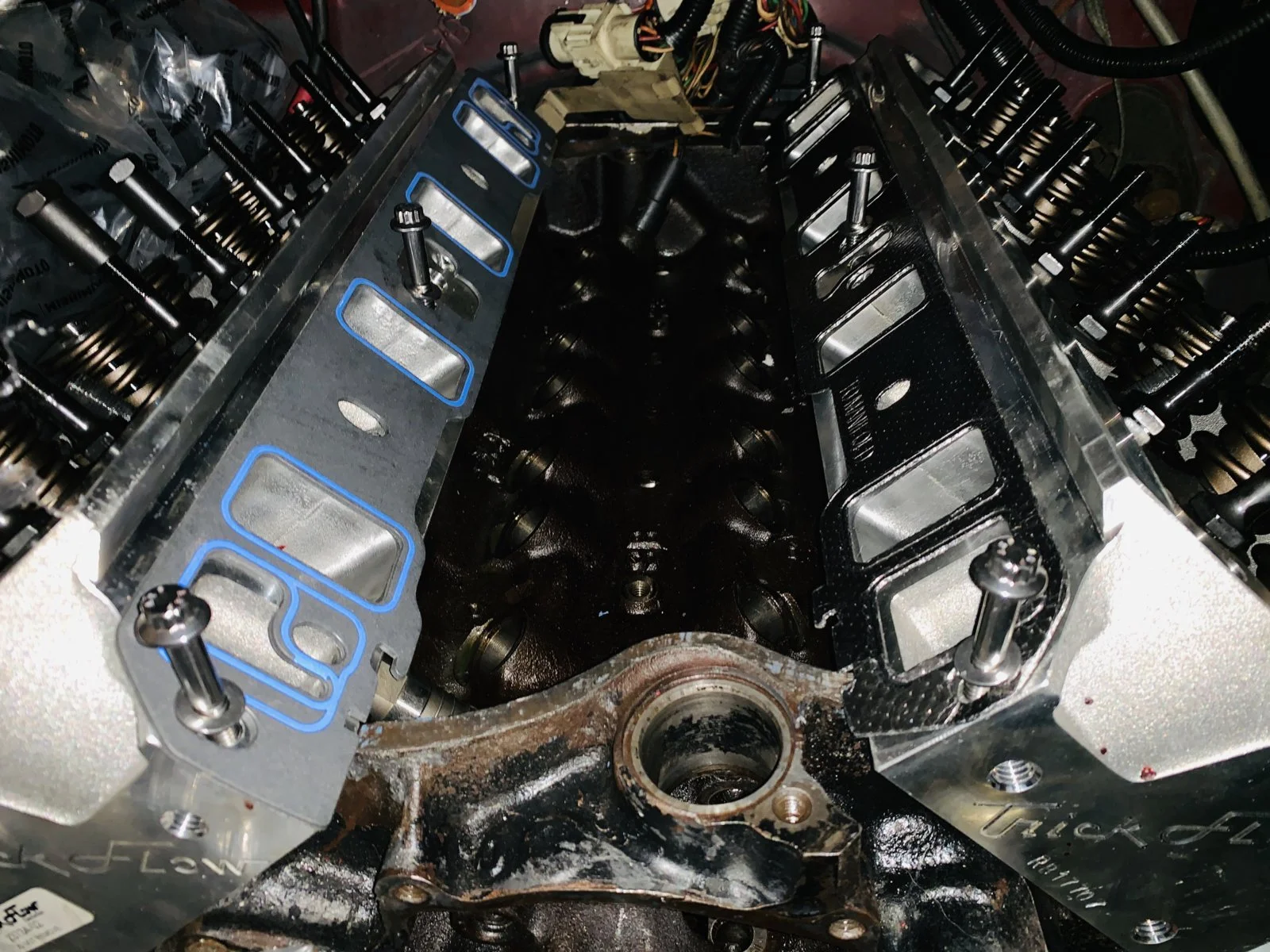

Chucking that intake & finding a decent one for 100$, bolt it up & never looking back would end speculation. Gasket pic’s below on TF heads, fit GT40’s similar.

So, going across that intake’s flange..there’s major pitting, (Heavy) file marks, and remnants of the filler(Blk. Arrows).

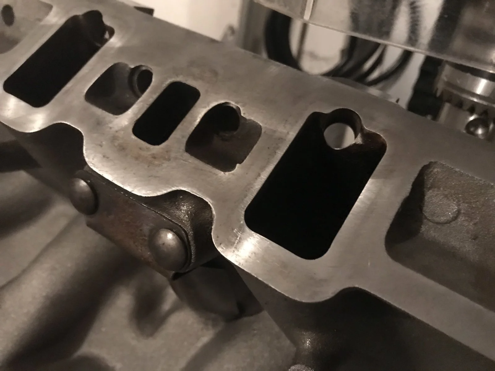

GT40P, reasonable surface.
Mock: Felpro 1250’s on left, Ford black graphite gaskets on the right; as viewed. TrickFlow T.W. 170cc hand polished ports.
