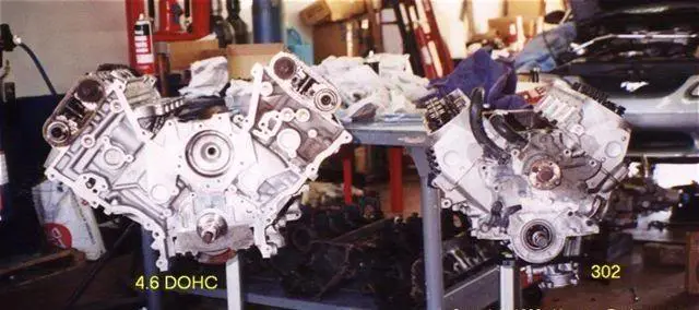

just a size comparison so you can get an idea:

oh i didn't realize it was that wide. I the sohc the same width?

Very nice pic. Ya the 4.6 is way huge. It's suprizingly larger than my 428. For your first swap I would stick with a 351 or 351 based stroker. Parts are readily available and more reasonably priced. You can easily build a pretty stout 351/stroker and run 12s fairly easily... as long as your suspension can keep up with it.
