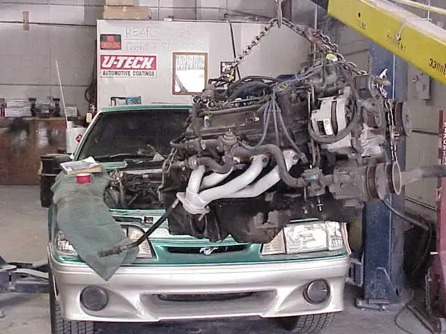

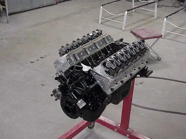

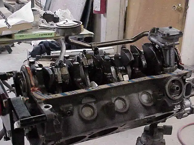

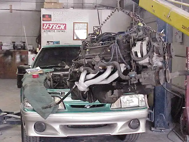

Engine first out

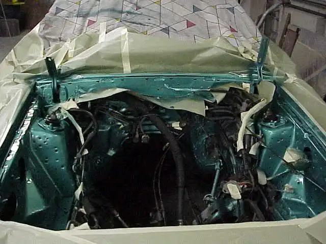

Bay First Painted

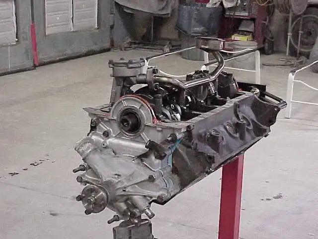

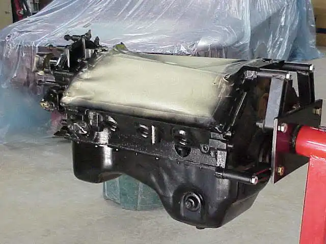

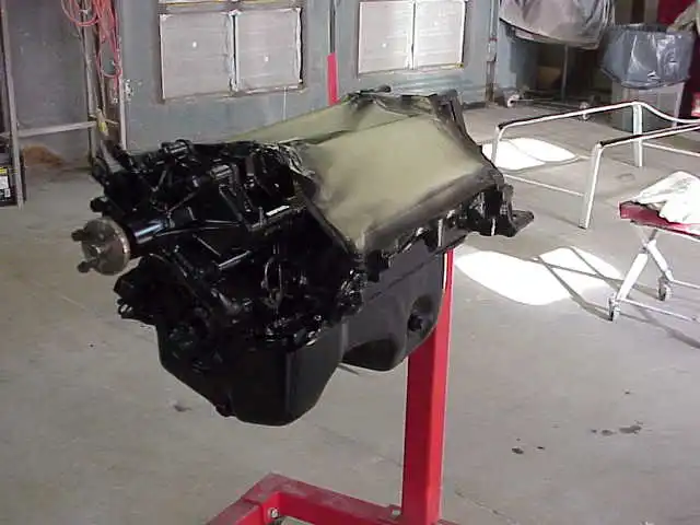

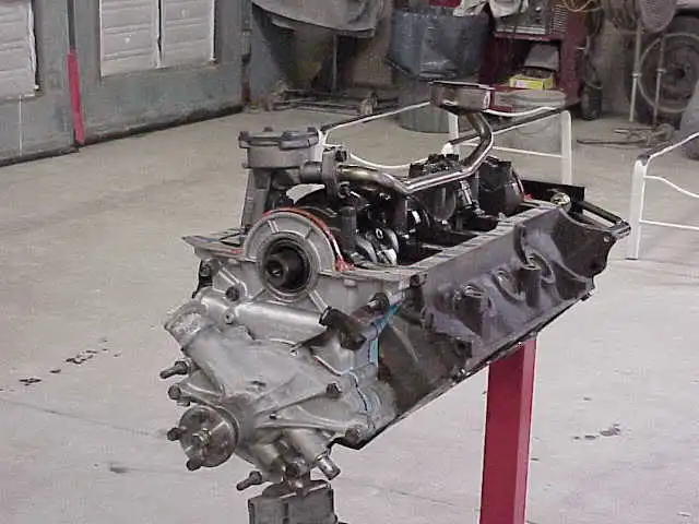

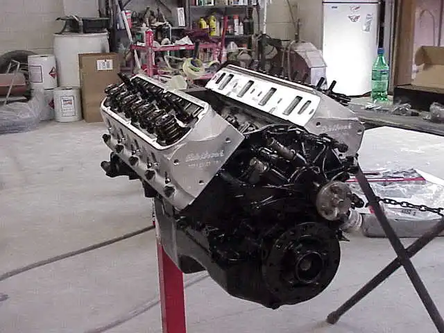

New Block, installed E cam, Timing Chain and Cover, Water pump, oil pump, pick up tube, and gasket ready for oil pan...

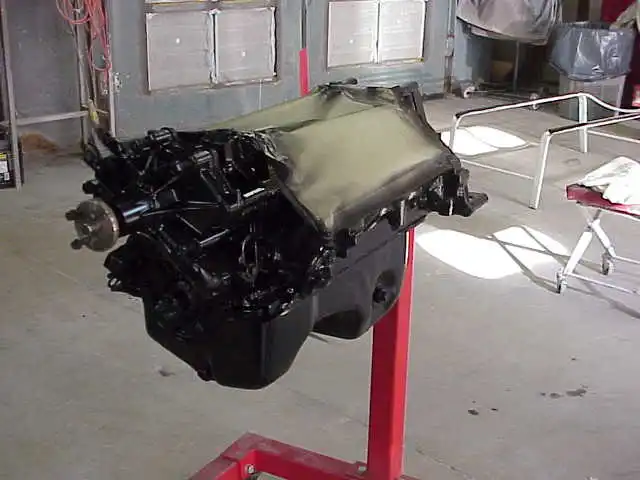

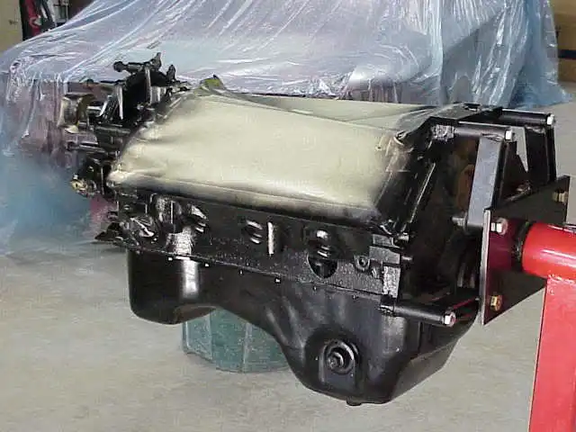

Block Painted, all black -

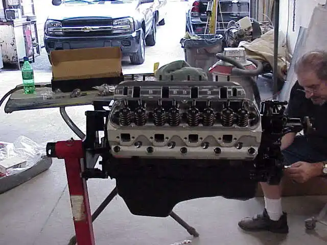

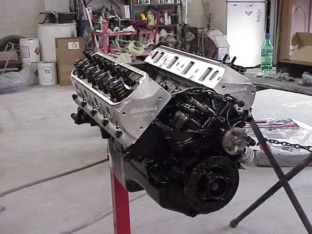

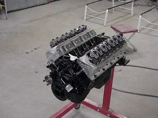

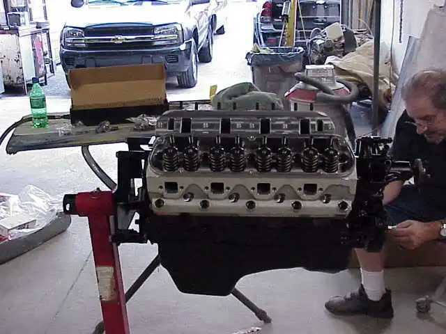

Heads installed - they look ****ing spectacular on there -
Roller Rockers and Pushrods installed - they look very nice! Crane 1.6's
This is the progress so far for this car -

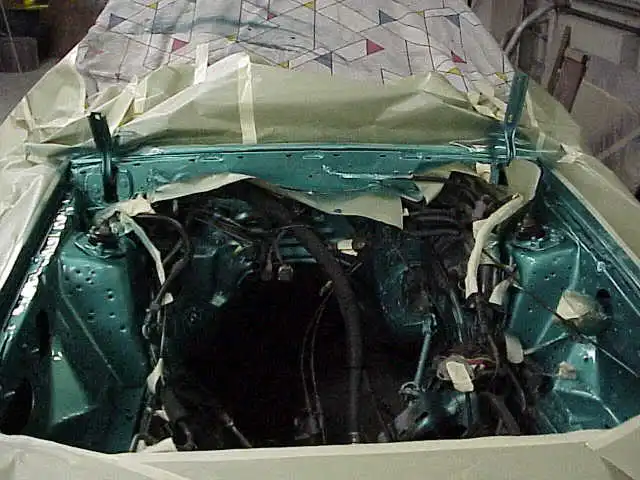

I hope so, and in response to the bay painting....
First, be discouraged, I was... I couldn't wait to do it, at this time the engine was still in, than when we got the engine out, i was like, ohhh shiiiiittt i have to do it and theres all those wires.... I unbolted as much **** as i could from the strut towers, and off the back of the firewall, taped up various things, and kind of airbrushed it, that way there would be LOW overspray, keeping it off the wires, and the wires that did get green, i touched them up w/ flat black... looks very nice - that solenoid mess with all the grounds, that's the biggest pain in the ass - but just unbolt everything, and drop it down out of the way - I didn't use an air brush, i just used that to describe a good way to do it w/ no overspray - i bought a fillable aresole can, (comes w/ a jar that connects to it) and i shot everything that was white, green.... next I only cleared the big areas - including the strut towers, inner fenders- and TOP of firewall - the rest is just green but you wouldn't be able to tell if it was cleared or not w/ an engine in the way -

and that old guy is my dad, owner of the shop - and my best friend lol He's never done a ford motor, but he's helping me through all of the steps - it's gettin done my friends
God I hope all this thing is is not just a hunk of junk, i hope it runs - it looks like it's gonna run!!

Good stuff Paul..lots of fun will be had. Remember when start up time comes to prime her up really good before first start. When firing it up have a jug of water ready to add to the rad when the temp gets up..you don't want the temp getting away from you and having to go running off to find fluid when the stat opens up. It's hard not to get distracted with all that's going on during the initial start...make a list and check it off as you go. Well worth all the effort.
yea it does i think - the new engine came with no timing chain cover, so i just glass beaded my old one, cleaned it up alot, and put it on the engine... however, the new engine came w/ the timing chain ON, AND it had a mechanical fuel pump cirular device on it - and my old engine did not... but we just left it on and covered it right over w/ the TC Cover- and it fits fine, but what is the deal w/ that comin with a mechanical fuel pump rotation device - was that stock or did the guy i got the motor off of just stick that on there???????
Was the engine previously carbureted? I don't know what year they stopped putting that fuel pump cam lobe on there. I know that my '94 5.0 in my '65 doesn't have that cam.
