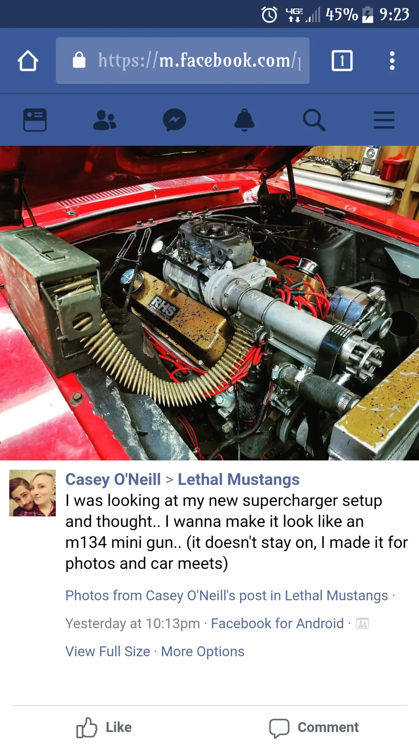

I think you know what needs to be done

He needs to work on the paint first..fenders look like he washes the car with a scotch brite pad...
Yup paint is terrible but waddaya expect for a 100$ backyard paint job?
It's a good 20fter
I'm talking about the red car with the fake mini gun Jeeves...
It's ALWAYS mustang goobers like this guy that being a "Ford guy" meant you were part of a freak show...
No detail in the engine compartment, turnbuckle strut tower braces, dirty, scroungy looking accessories, a " what the hell was he thinking" exploded rattle can treatment on the valve covers and radiator....
And that wanna be mini gun barrel shooting straight into the radiator....
Some guys are meant to just leave their sht alone..
