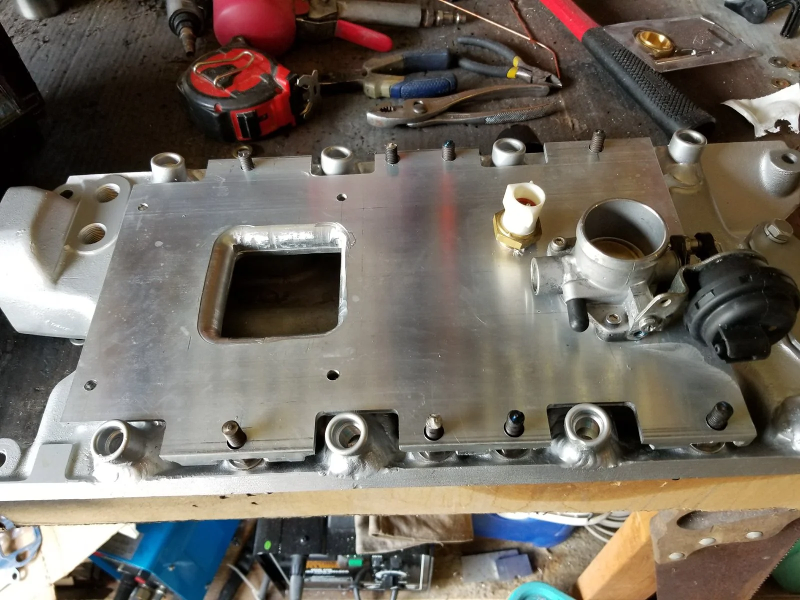

Noobz347 said:
Does the possibility exist that a gasket has slipped or are there any foreign nozzles or obstacles in the path of #7?
maybe? [ i think you meant #4?] there is a temp sensor mounted in the rear of the intake but it takes up little room and does not block the runner at all.
the injector pairs are 1-6, 3-5, 4-7, 2-8
runner #7 has the bypass valve closest to it i suppose...

So may some smoothing around obstacles? I'm guessing that the fouling is not occurring during boost. You would likely feel or hear it.
smooth wha?

So the fouling of the plug makes no sense to me, it has to be another issue. Air flow inside the manifold makes sense to some extent i suppose... you would think if it were reversion both sides would be fouled but the bypass valve favors the driver side.
Now if we think back i already pulled things apart once, re-angled and moved the injector as close to the rail as i could... they all spray directly into the runner. this was to account for a 'reversion' issue before...
I ordered a noid light to test the injector connections, maybe something funky i cant see otherwise is happening. maybe the light will be brighter on that one injector, or the light will never turn off indicating some kind of small short or some such...
I went ahead and ruled out the possibility of an intake gasket shifting, i copper coated both sides of the gasket before installation. I was also able to verify before installing the blower assembly.

Could still be an injector that flows funky?

Thats why i am going to check the wiring, i already moved the injector that was in this hole to cylinder #5 which was a clean plug.

And buy a couple new plugs, that one is, well, kinda broken.

For a noid light, use an old socket holder and a 912 bulb, or 921, whatever it is. Works really well.

Sorry if I missed it, but have you verified that the plug is actually firing? My next guess would be to ask if it is fuel fouled or if it is oil(valve seal)?
Joe
I have changed plug, wire and coil pack... just removed the pcv system and went vented... we will see what happens.

Have you seen spark at the plug?
Joe
no... i havent checked for it i guess i just assume it is fine... same fouling with different plugs, wires, and coils.... just the one cylinder..
I will take any and all advice
You are way smarter than me with this stuff, just know sometimes the simplest answer is the correct one. Good luck!

Is the engine running bad? A wet plug Is typical of a plug that isn't firing,....And If you don't have all 8 cylinders firing, I'd have to think that you'd have a stumble/pop/backfire if one of the cylinders wasn't firing...
Maybe it's just idling fat because of poor distribution at idle,...and that said,..you shouldn't be able to have such a clean running low speed idle if that plug isn't doing the job....But you do...Right?
engine runs very strong, no issue i can pin down... the plug is not wet just sooted up... like excess carbon sooty its soft and wipes clean easily.
As an experiment i removed the recirculating catch can and vented it, I also moved the MAT sensor to its original location and placed a "fresh air feed" directly into runner #4 so at idle and cruise it will hopefully help if there is any poor distribution...
I let it idle for an extended period this afternoon and did not notice any loss of idle quality after 20mins I will pull the plug in the morning and see if it is fouled..
