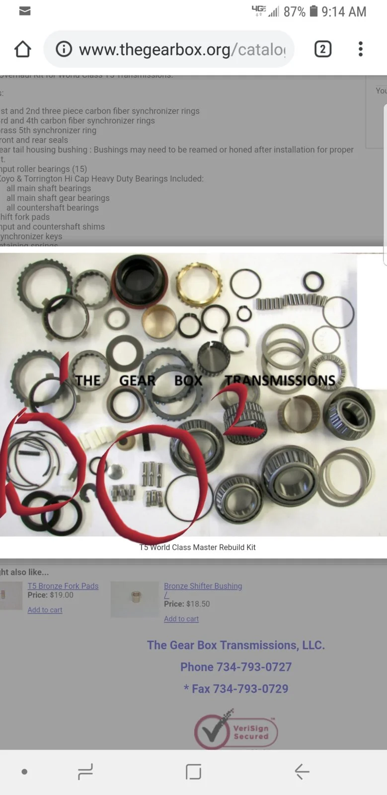

Typically a synchro will cause a grind... not a full lock out feeling. If it feels like you're pressing the shifter against a brick wall then it could be a different issue. It may be due for a rebuild though.
If you need to pull the trans, you can do it without removing the bell housing.
I'd try a fluid change first. Maybe even a bit of Lucas. The synchros slow the gear down so it will engage. A bad synchro will usually cause the slider ring to contact the dog teeth... usually on the gear side. Worn detent springs and keepers can cause a stuck in or out of gear issue.
As the fluid thins out it can cause these little rectangles to get stuck.
1. Are the detent springs
2. Are the keepers or keys
In a high friction situation they can lock you out of gear. Synchros typically cause a grind associated with not being able to get in gear.
