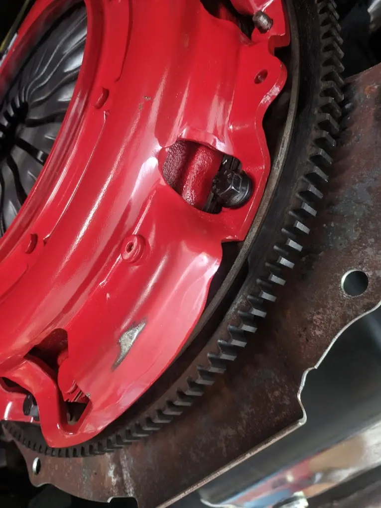

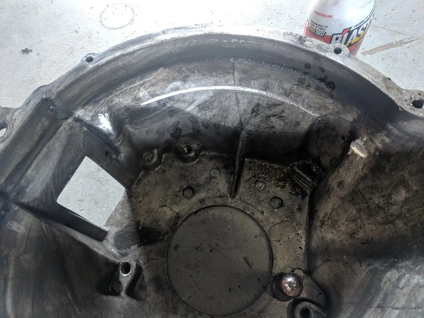

Edit: Wanted to share a couple pics I took showing the pressure plate and bellhousing after their "self-clearancing" exercise

I'm just gonna go on record here as stating that I beleive that that clutch is gonna be your vibration issue. Think about it.
Manufacturers have been building those clutches to fit that bell housing for over 30 years, and now all of the sudden you get one that dont fit. The Clutch is part of the rotating assembly. If that pressure plate is somehow built incorrectly, you'd think that they know that you are gonna have interference that youre gonna have to clearance. That interference is because something aint right.....and now its spinning at 6,000 rpm. Unless you bought some sort of Chinee "Made last year" brand, then as soon as I discovered the rattling clanging noise after startup, and determined that it was the clutch,..I'dve been making my next call to the clutch mfg.
Does your engine have the block plate that is sandwiched in between the back of the block, and the front of the bellhousing that locates the starter?

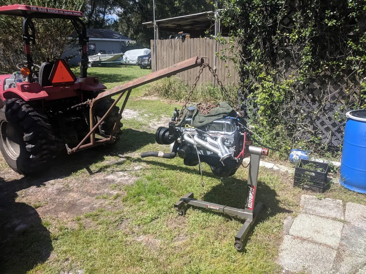

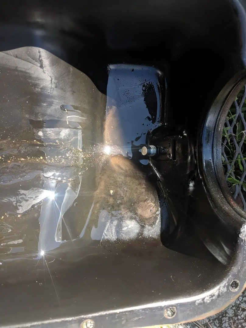

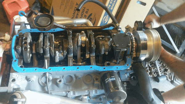

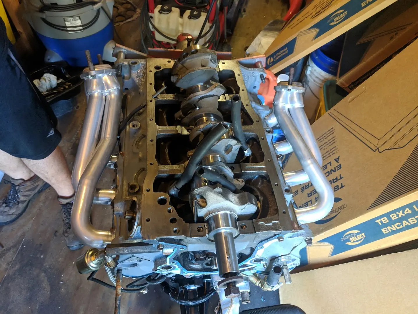

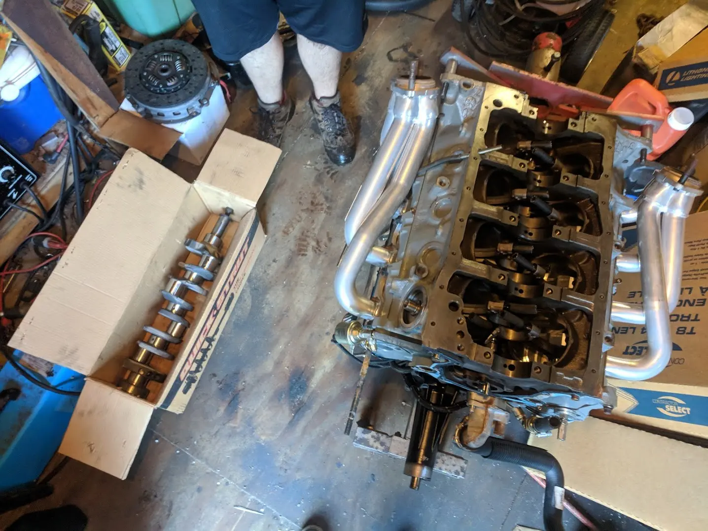

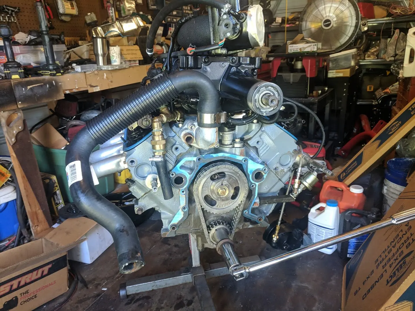

Pics from FrankenCrank-Swap 2018. I hope they'll do, Mike
The patient sedated and prepped for surgery:
Freshly brake cleaned donor organ:
Set in place with some longer hoses added to allow for better maneuvering of rods:
Timing chain installed:
All dressed and ready for the dance:
Reactions: Anti_Hero0932, 02 281 GT, RaggedGT and 2 others

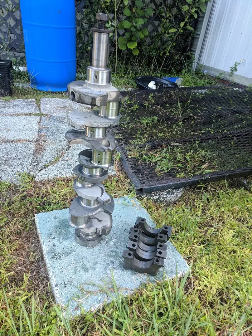

If you guys aren't using a tractor for an engine hoist, you're doing it wrong :
Out of order (was gonna put at the beginning but dumb 5 image post limit and didn't want to re-upload ) but the reason for the swap:
Bonus:
Reactions: 95BlueStallion and RangerJoe
