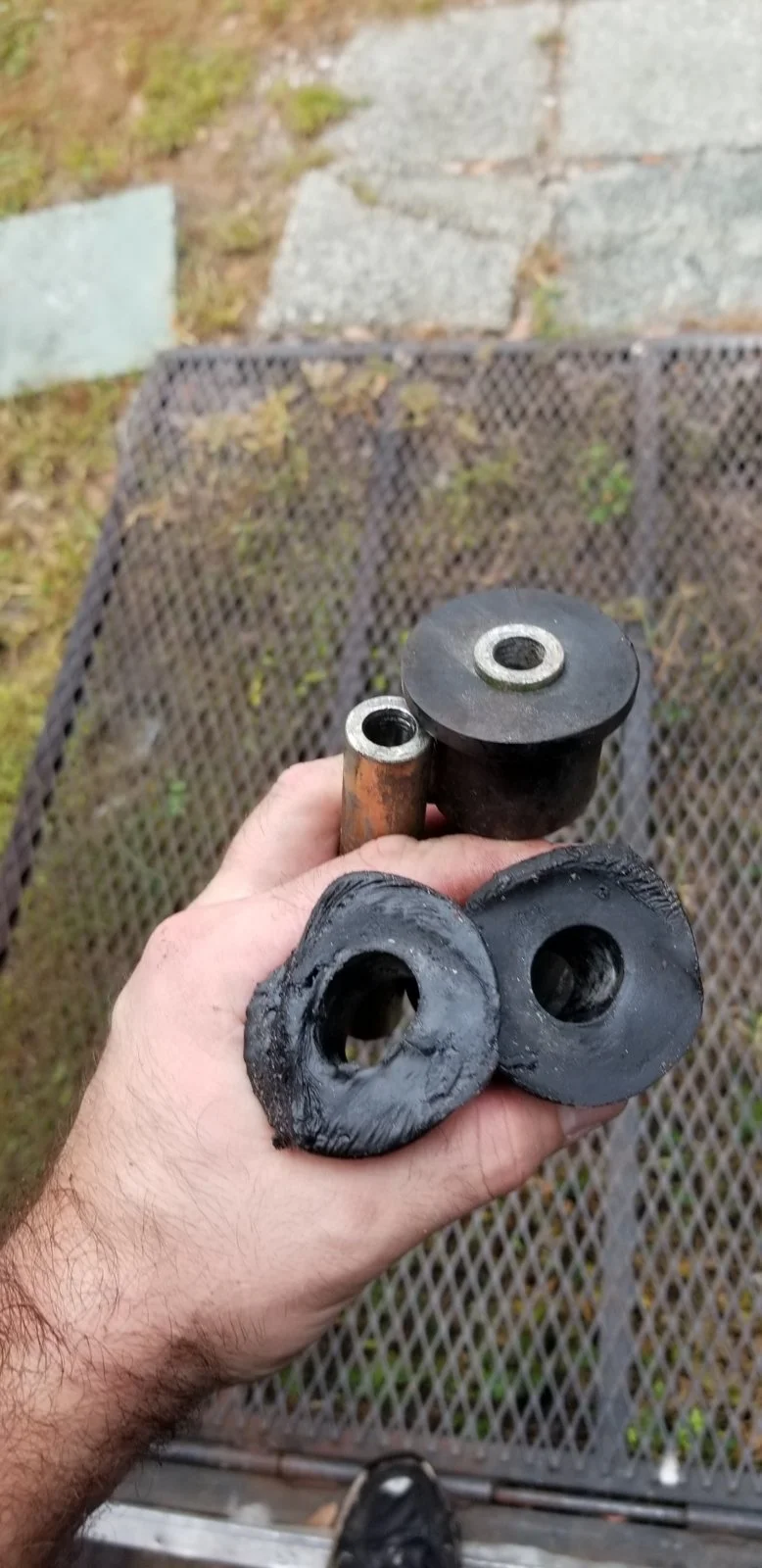

I'm no expert but these may be the vibration issue.

I also found a very broken passenger side motor mount.. so the whole drivetrain was likely wobbling, luckily the auto parts store can get me the motor mount.

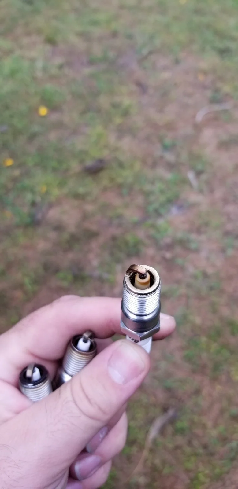

Trouble shooting today, new plugs drove 40miles and pulled them. Cylinder4 is dead apparently, compression check shows 180psi. Here is a pic of the plug from that cylinder.
You'd think that you would've been able to feel a dead cylinder. And if it's got compression, and the plug ain't wet, it's easy to figure out why it's not coloring like the rest..... if it wasn't firing, it'd be wet.
It's not wet,...so....injector?
But, looking at the other plug in your hand...it's insulator is white, the one between your fingers is tan...somethings goin on.

I can feel the missfire it is very apparent something is wrong I just dont know what.

Well found my culprit I think, testing injectors now and I have no power to at least one of them. #4 with the funny looking plug has no pulse doing an output test.

Wiggled the wires where they go into the ECU plug and now I have that injector pulsing again... this may be why I had missfire issues plague me for years now off and on. Going to try and tighten up the pin connection
See...told ya.
Easy to figure out.
Probably the vibration you're feeling too maybe...

drove the car into work, she is running 100% better now. its amazing how one cylinder being down can create so much vibration.

Glad she's running nice again for you though Steve. Did you get the motor mount swapped yet or just the cross member bushings?

just the cross member for now, trying to get that 500 miles on her to break the clutch in
